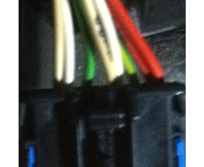

Hi
My headlight levelling dosnt work, even the little LED within the contact dosnt light up
I took the contact apart and i have tried to messure if any power is present but i only get 0,03v between power and ground??
Power - Green (pin 4)
Ground - Green/Yellow(pin 2)
Could it be a bad connection at the other end? and how do i get to the other end of the wire?
according to haynes i should terminate in the Passenger Fusebox (BSI) It seems to go on the back
Any help would be appriciated

Tried swapping out the complete switch unit?
