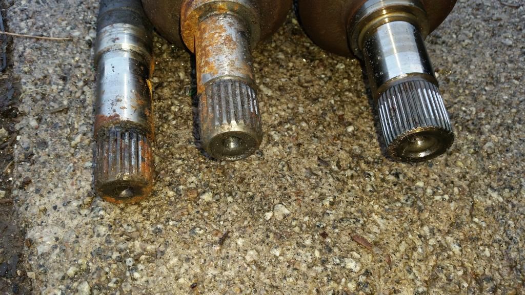

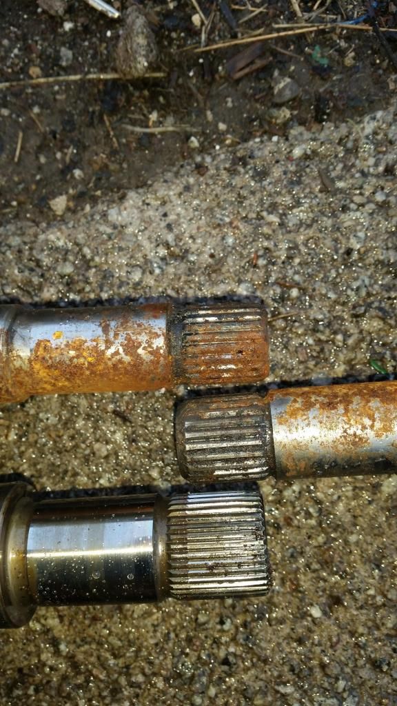

one with more splines is v6 one totally different
bottom one v6
3 different inputs to 3 different boxes

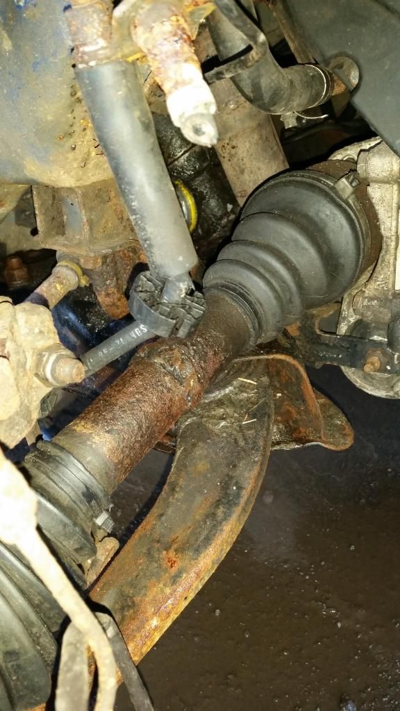

that drive shaft looks scarey to me

I ment to say NOT a concern, but still that welded shaft looks dodgy as!
Best of luck anyways though

I'm not worried about it just looks bad in pic plus its nice and rusty. yes wiring is great fun need to run 2 ecus trying to get all under bonnet is to fun
