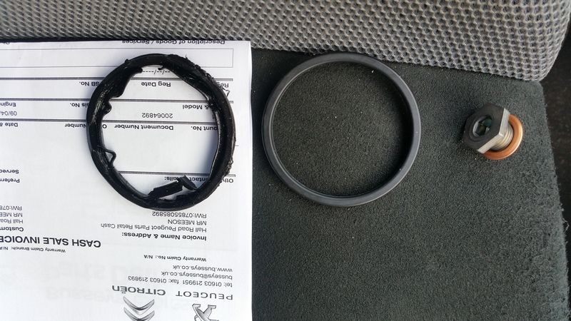

This washer goes between the oil cooler, further up.
I wonder if I replace it if it needs to be torqued up?
Thanks

Shall hopefully be getting my new washer Thursday. When refitting is the a torque setting for the big bolt that screws through the oil cooler?
I would imagine there is considering there is a gasket behind it. Try it as hand tight plus a quarter turn and see from there, most rubber seals will be crushed beyond this point.

I have the new seal. Peugeot state a 8 nm tightening! Isn't that hand tight?
Without a torque wrench its hard to say

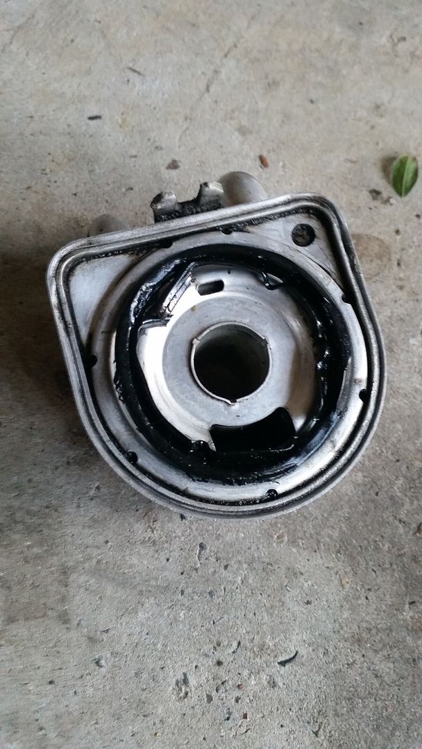

Could go for hand tight plus a 1/4 turn!

Not too much difference

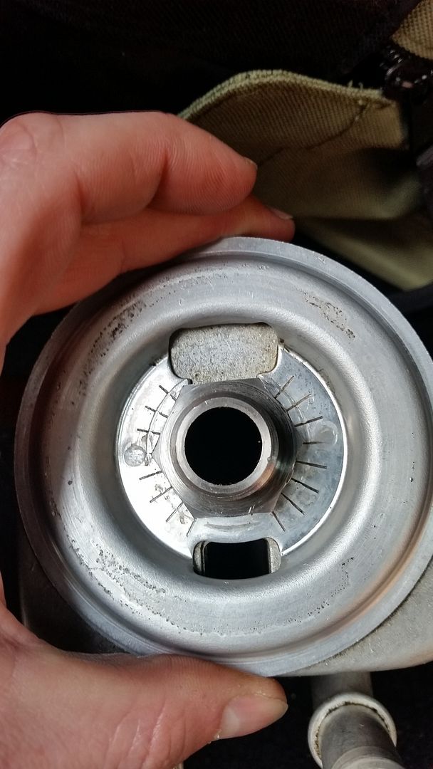

I found the cooler had lines on it so I hand tightened it then aligned it square
