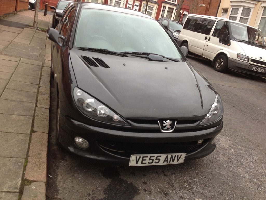

So I scrapped my old 206, sold my bike and picked up a new 206, found the exact one I was looking for, a 1.4 16v sport with the black/red interior. It's a 55 plate with less than 100,000. Body works tidy for a 55, needed rear wiper painting (or removing) and a good waxing.
The day I picked it up:

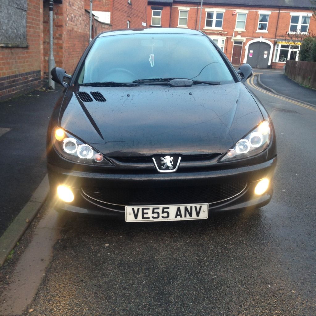

Angel eyes in:
And wired up:
Wing mirrors on and wired:

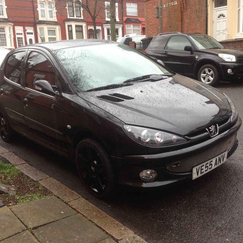

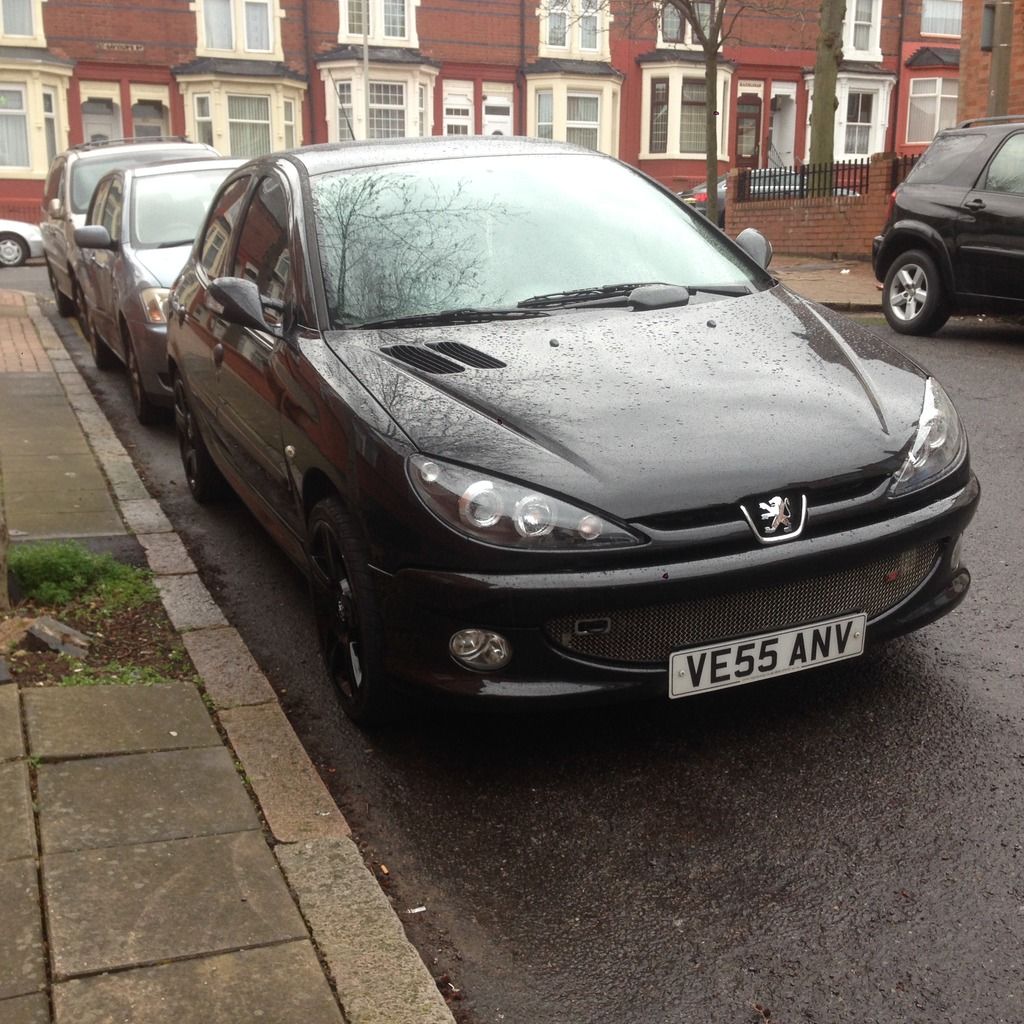

Got a better picture of the car today, still not put the sp lower grill or spoiler on, waiting for a dry day. Looking a bit tractory with the 17's on tho so next buys going to have to be a pair of coilovers!

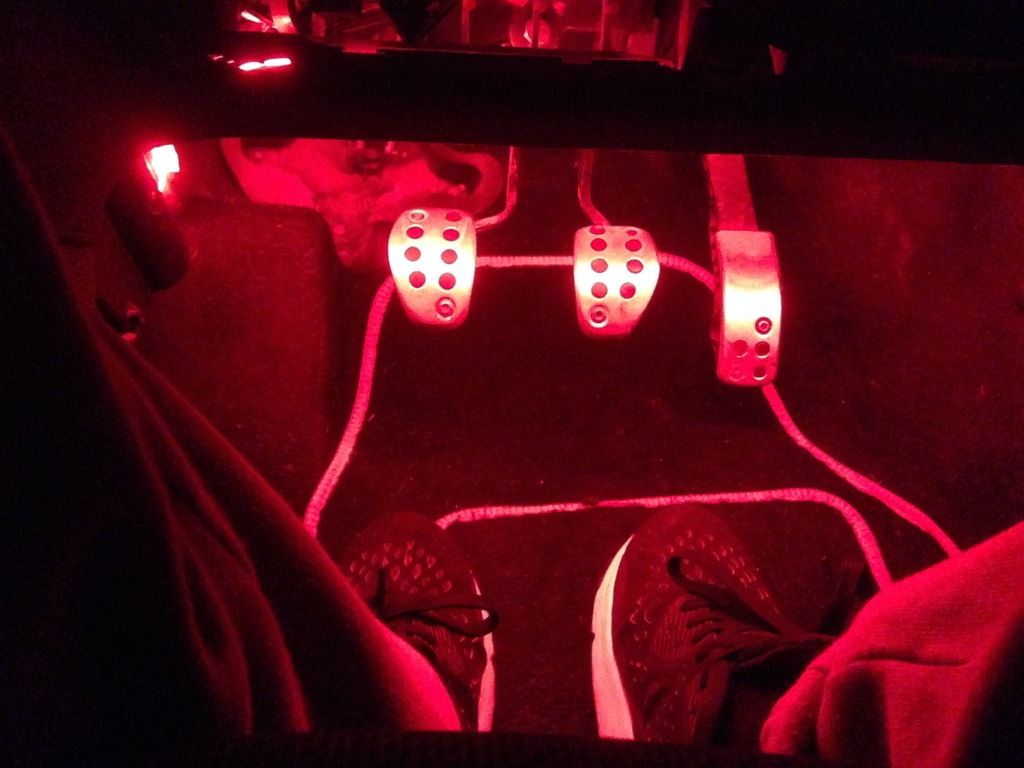

Got my red smd footwell lights in today
(fuse box cover was off because I had to swap one)
Little video:
ran them off my halos/drl's for now but still not sure wether to keep them there or have them on the courtesy light, will get some pictures up tonight when its darker. Going to put a strip in each door card ( in the storage bit) and one underneath the front lip of rear seats to light up rear footwells when I get some more time.

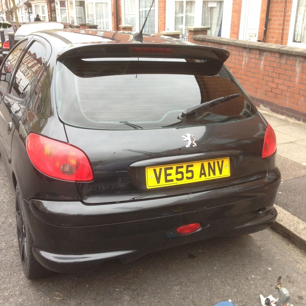

Finally managed to get some time on the car today, it was nice and dry so I threw a clear coat on the spoiler and got it on, tiger sealed it because I didn't want to drill the bodywork, no need to risk rust if I don't need to!
I partially de-badged the rear aswell, not sure wether I want the lion or not yet, probably get rid when I get the badge less front grill on?
Can still see the writing in certain lights but not cutting it in yet as I'm going to buff and wax the whole car soon.
I slapped an abarth spoiler on the misses 500 while I was at it aswell
FINALLY managed to get my gearknob off (took my biggest pair of grips and a lot of swearing) so I've got my red leather gaitor on now and temporarily got a red and black leather gearstick, can't decide if I like it better than my silver golf ball yet?

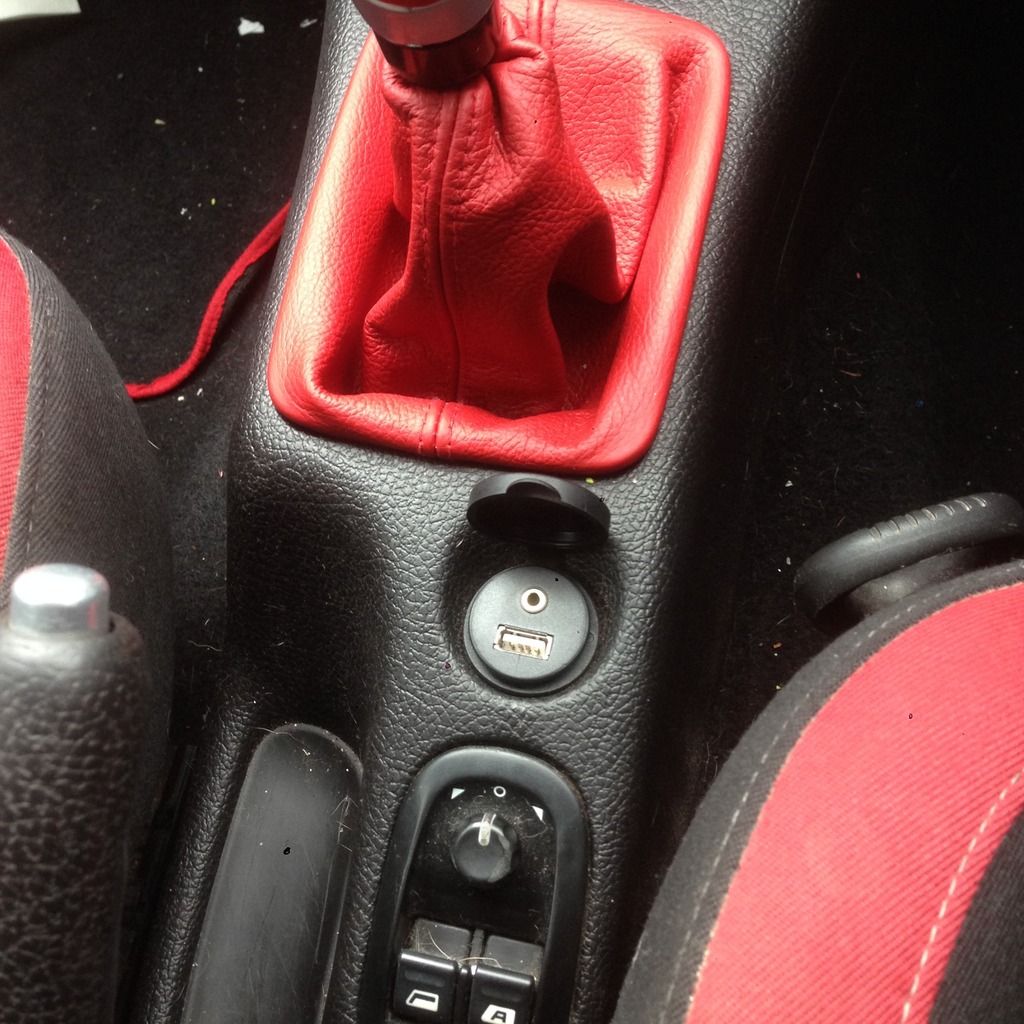

Had an idea lastnight, need to extend my aux cable so going to get rid off my cigarette lighter, wire in a transformer to drop it down to 5v and have a flush mounted use and aux port there instead, ordered the bits so when they turn up I'll whack some pictures on. Anyone else done this?

Good job on thinking to convert 12V->5V, I'm such a bad (non-)electrician that I keep thinking any voltage transformations still emit unnecessary heat (=waste) Smile

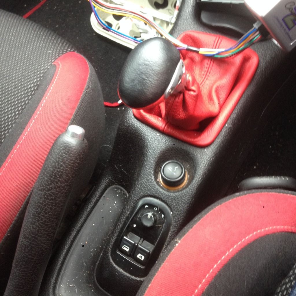

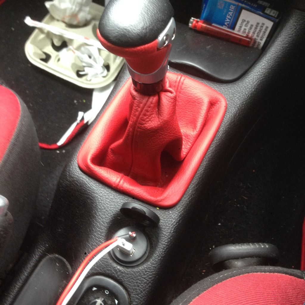

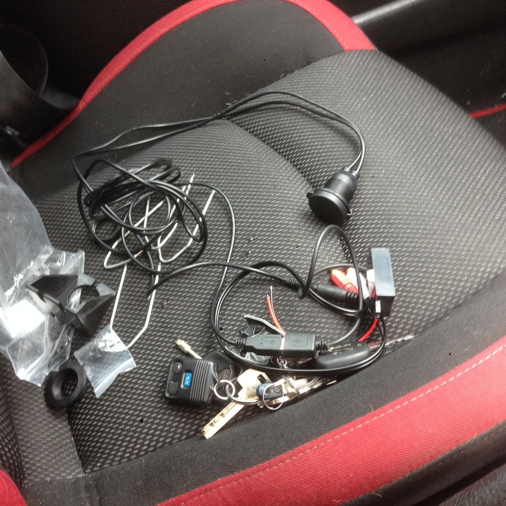

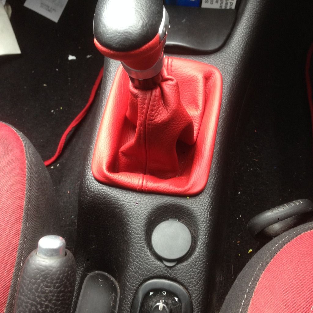

Managed to get my usb and aux point wired up today, stuck with my idea to replace the cigarette lighter and I'm pritty happy with it. Went a lot easier than I expected, took about 15 mins all in.
Anyway here's some pictures, let me know what you think:
Before:

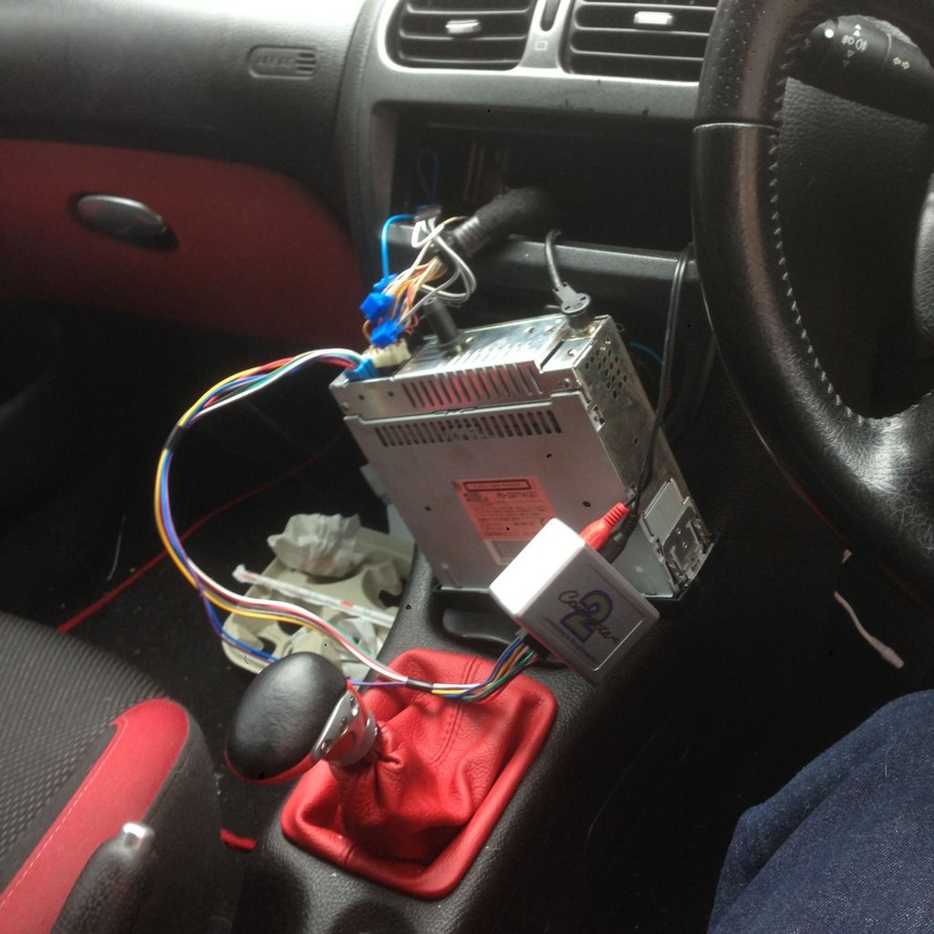

During:
Some of the wiring(aux and usb point, 12v-5v transformer, 2xrca - 1x3.5mm jack)
Also got a connects 2 unit which plugs into the cd changer port on back of stereo, means I can have an aux lead on standard Peugeot head unit
After:
Thinking about spraying the cap red? Laughing
