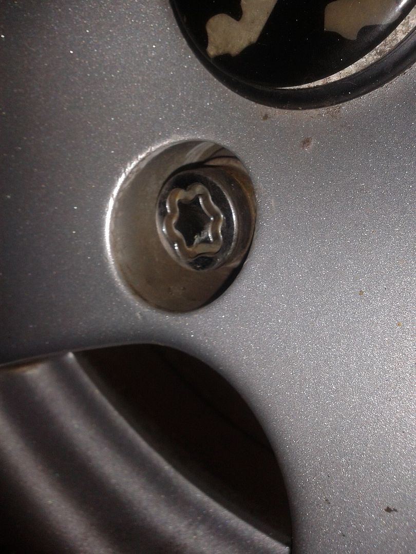

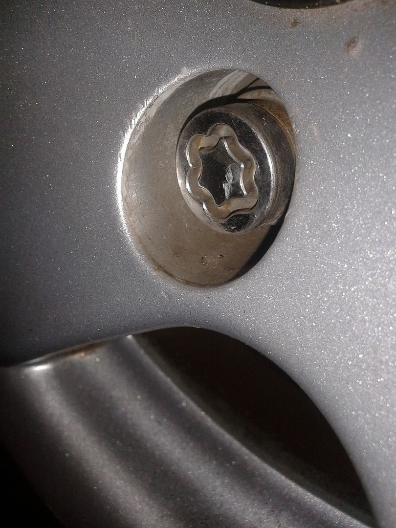

i Recently bought a 1.4 Hdi which had peugeot alloy wheels fitted,not sure if they were from new or not but the previous owner didnt have the key to remove the locking nuts on each wheel.
Is there anywhere i could purchase the proper key to remove them or to i have to resort to hammering on an old socket or something and using brute force to get them off? (really dont want to do that and damage the wheels themselves)
Car is due its MOT so really need to get them off ASAP
Heres a couples of pics of the locking nuts
[img]
[/img]
[img]
[/img]
Thanks in advance for any help

There McGards, get in touch with McGard & they might be able to make a replacement key from a picture.
Thanks MrBSI,i had a look at Mcgards website and narrowed it down to being these bolts for a peugeot
mcgards
but looking at the pics the mcgards bolts have 5 points in there pattern where as the bolts on my car seem to have 6
On another forum a few guys have suggested that these are not original locking nuts and suggested maybe going down the road of buying a removal tool from the likes of halfords such as this one
Halfords
will post an update when i get any further on with this
Cheers Terry

They are definitely McGard lockers. Doesn't matter what car they were intended for, email them a few very clear pictures along with a copy of your V5 and driving licence and they will be able to cut a new key. Just remember to tell them what hex size you require.
I had 2 keys made up a few weeks ago for about £25 delivered. If you need them off quickly then they can send them out express or alternatively you will need to get them removed.
