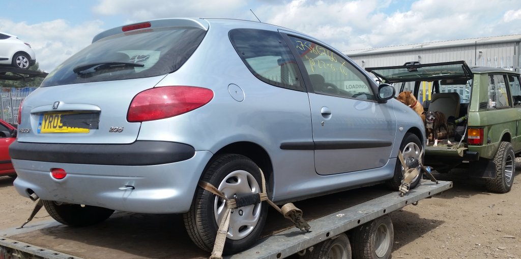

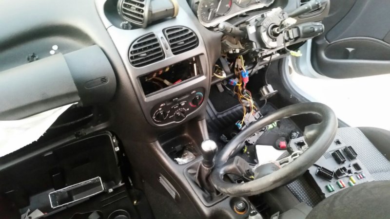

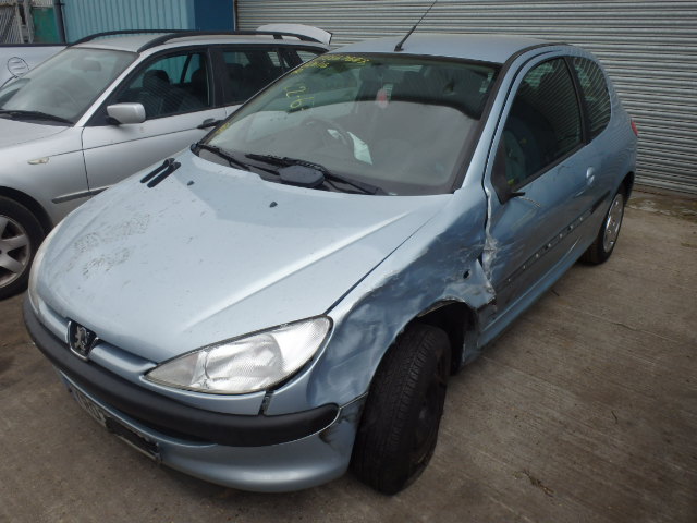

Hi folks, I bought a 2003 1.1 (HFX) car with 46,000 miles from the salvage auction thinking it would be a relatively easy fix (front wishbone,strut,wing,door,airbags,seatbelts,module.
All that stuff is now sorted (sill still a bit bent!) however the car had no key with it. I managed to get the blade cut so the locks are working , I bought a new ID46 chip from Ebay but I am struggling to get PP2000 to add it to the car. I have the 4 digit code.
To make matters worse I tried another BSI/ECU,chip from a spares car I have sat here and while it started and drove fine, the speedo didn't work, I now realise this is probably because the donor BSI was from a car with ABS so it was expecting wheel sensor signals rather than gearbox sensor, and sure enough the donor car gearbox has no speed sensor on it by the look of it.
So I am back to my original BSI, but the mileage from the donor car (70K) is still displaying on my dash, do you think the dash has transmitted the mileage back to my old BSI? Evil or Very Mad or will getting the dash corrected be enough? (If I can find somewhere, again anyone on here able to do this?)
Thanks folks, hoping I did the right thing by tryhing to save a 206 from the crusher but I am pulling my hair out!
