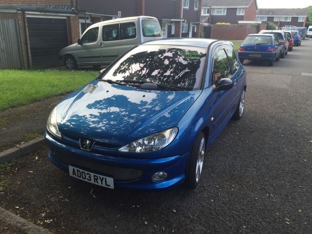

Hello all,
I'm new to the peugeot scene, had a variant of different cars in the past, from turbos to v8's but wanted a capable and reliable track car, was originally looking at Clio 182's but fancied being a bit different then come across the Gti 180's.
Spent a few months and a few wasted views looking for a half decent one when I came across this decent Aegean Blue 180. Seemed good enough and was close enough so I brought it, it needed some love but overall was ok.
So plan to start with was to get it back up to a decent standard, changed rear lights back to standard, fix the rear boot lock, etc

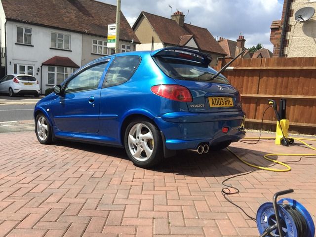

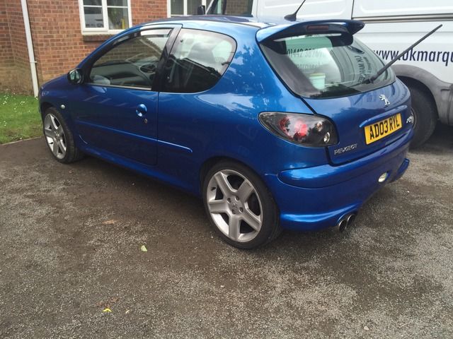

Here is a few snaps of when I collected the car / advert photos

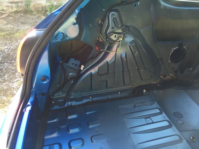

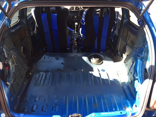

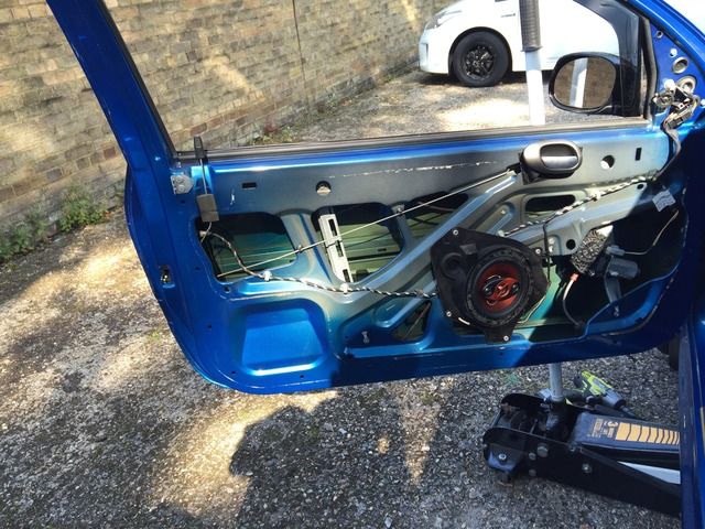

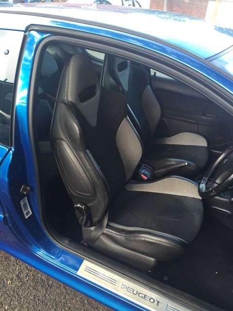

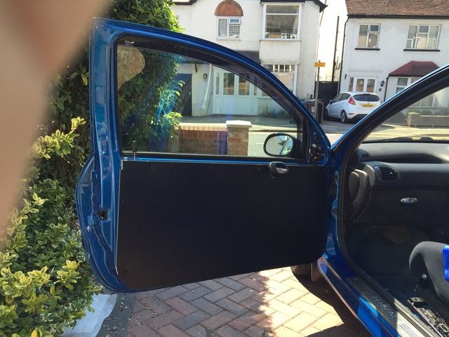

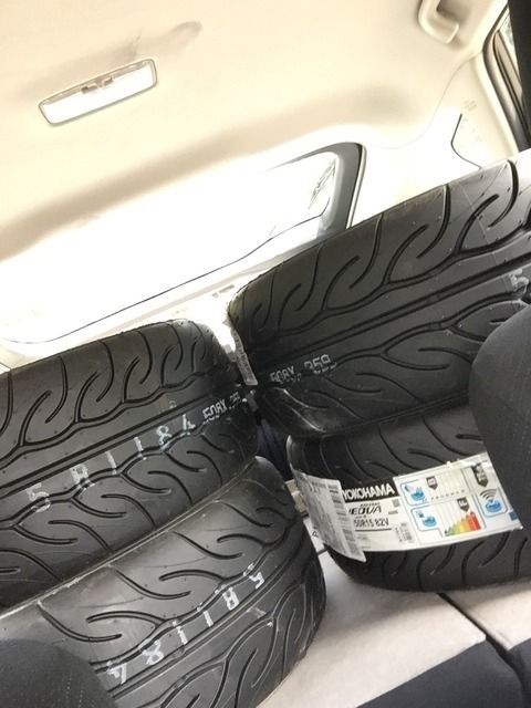

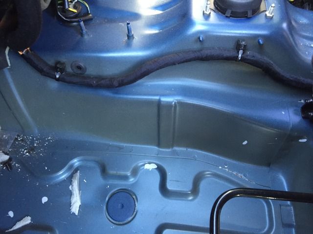

Thanks everyone, done quite a bit to it over the last 3 months since I brought it,
changed the rear lights back to standard,
removed all interior,
added 2 bucket seats,
Removed door cards and made replacement blanks
Neaten up all wiring
6point fia approved harnesses,
safety devices cage ( which is actually getting fitted this week)
rear anti roll bar,
gas coilovers,
15" track wheels and ad08r tyres,
yellow stuff pads all round,
5.1 brake fluid and drained out all old fluid, ducts to cool front brakes as found they fade under constant breaking while on track
Looking at fitting a 19 row oil cooler when back from getting cage fitted

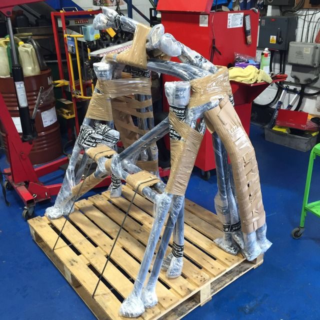

There's my cage all ready to go, hopefully that's in by the end of the week as at Bedford autodrome on Saturday!
