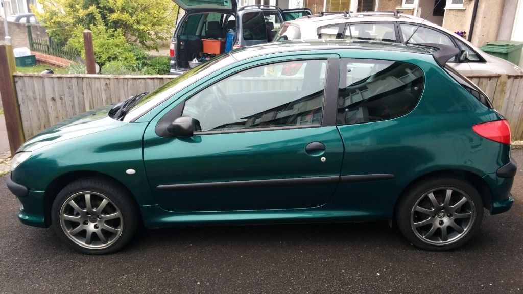

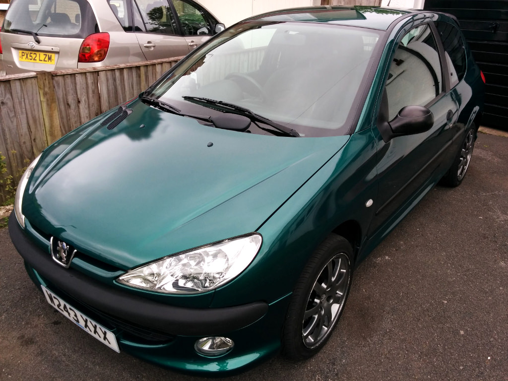

Finally swapped 207 15" Monacos with Andrew's 16" gunmetal grey Nimrods
Plan to refurb and repaint them same silver colour as Monacos

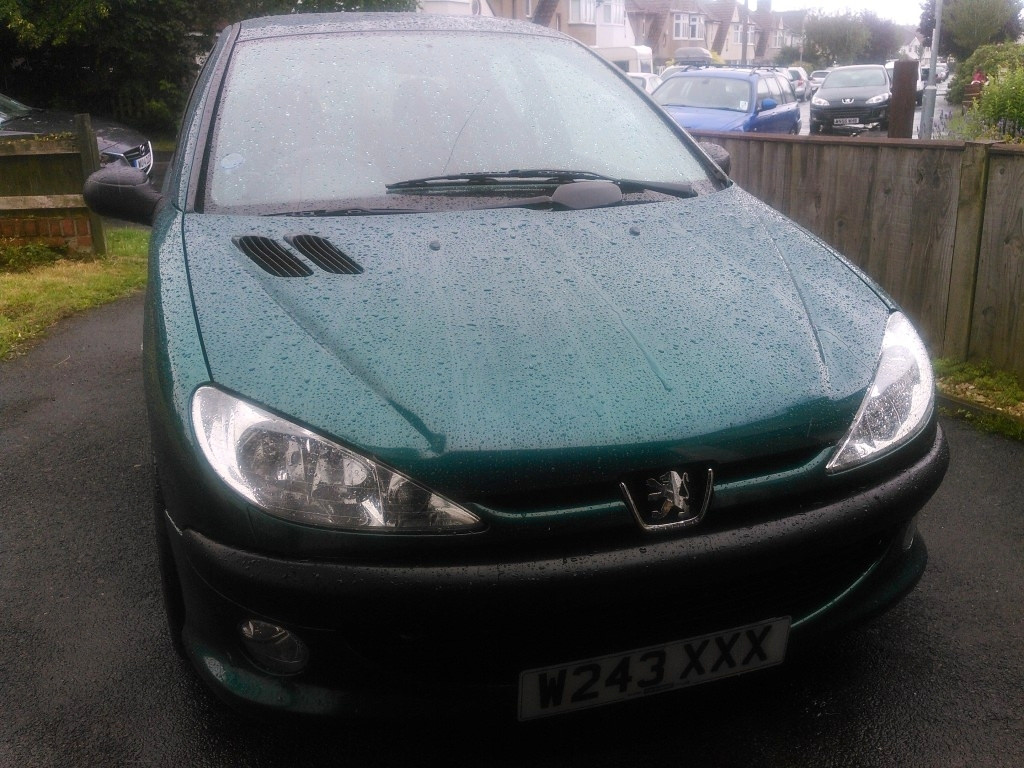

MOT is sneaking up, time to aling the headlights as youtube instructed:

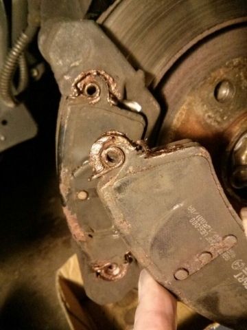

Fit some nearly new pads I salvaged years ago
Had an unfortunate buckled wheel hub back then, which kept on warping nearside brake disks. It cost me a couple of pads'n'disks replacements until I found the root problem. Had a gut feeling to keep these pads, and voila!
Made sure to copper grease metal2metal touching parts, and never heard a squeek from them! (previous pairs squealed like a pig..)

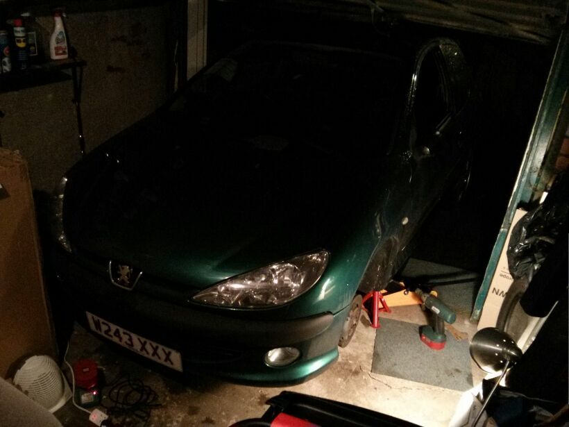

Had just a day to replace pads before the MOT re-check! Working in cold...
...asks for retreat to the garage with a heater. What purpose are such tiny garages built for? To fit a Mini? Very Happy

If leave the wheels that colour mate they set of that paint off lovely just needs lowering a little Smile

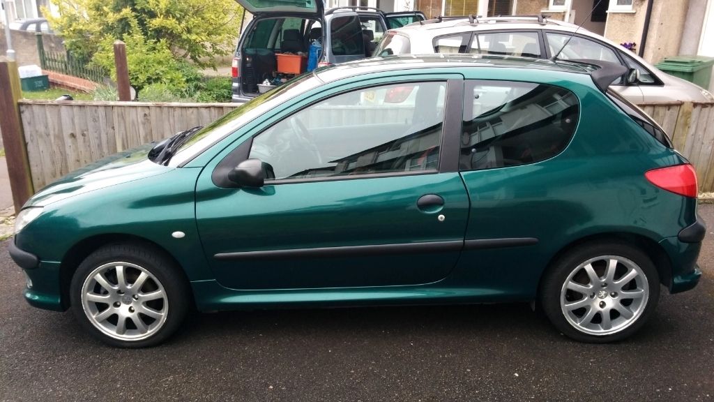

Yo bro, good to hear from you! Yes she needs lowering, but I want to get it right rather than get it done Smile
I know it's far from MattyP's lush'lloys Wink but I do miss the shiny Monacos: to my mind they went along with headlights and side indicator (see my avatar pic). I won't tint/change them headlights, as the goal is to keep it OEM clean.
After some photo editing, rate it or slate it Very Happy

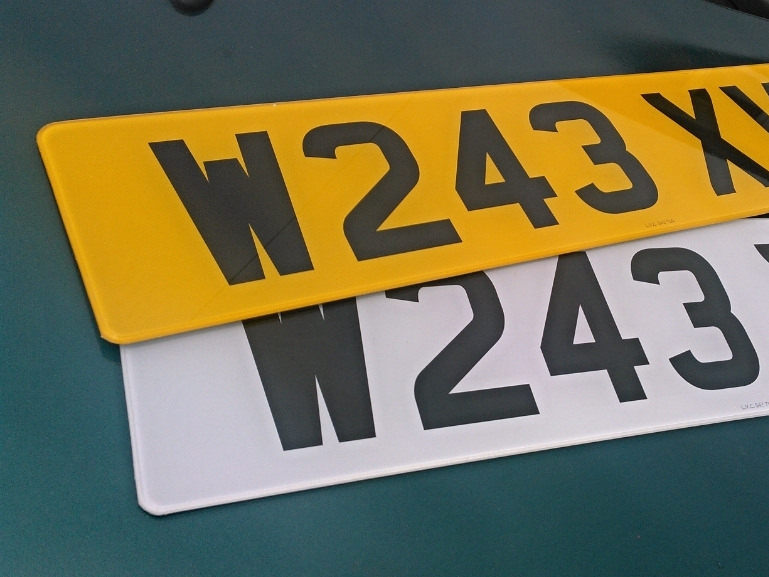

In the meantime these dropped on the doormat this morning,£5.98 each from fleabay:
Thought about pressed plates, but all of them have that ugly coachline, whereas this project is going for the clean looks.
The old ones've become somewhat opposite of clean... Shocked

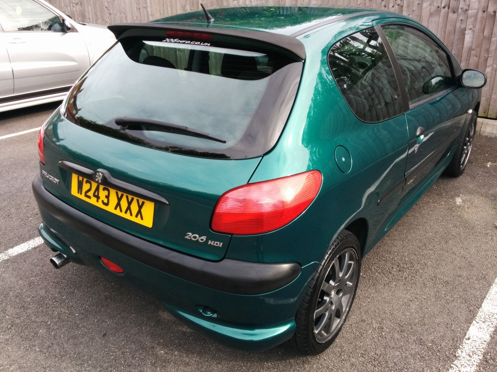

Gutted that will have to give FCS a miss this year, but all that work on the car pays off nevertheless to soothe the soul and comfort Smile

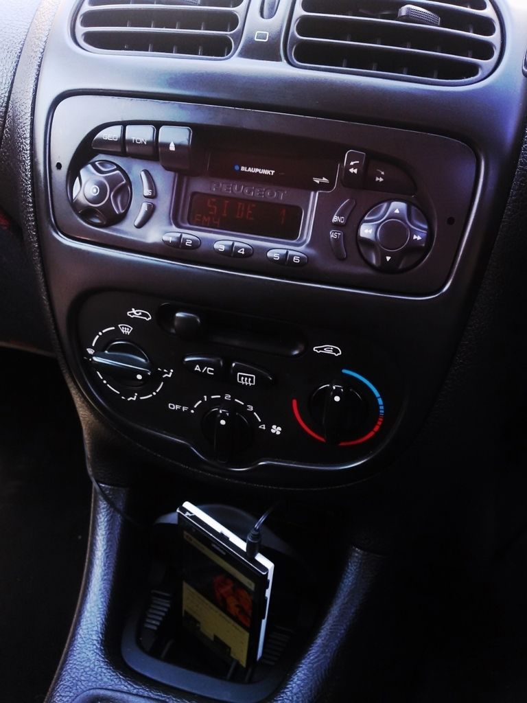

Wired a permanent iPod/MP3 adapter from an old stock cassette player over bank holiday, read howto here:
PlastiDipped the wiper cover trim and gave a good polish+wax:

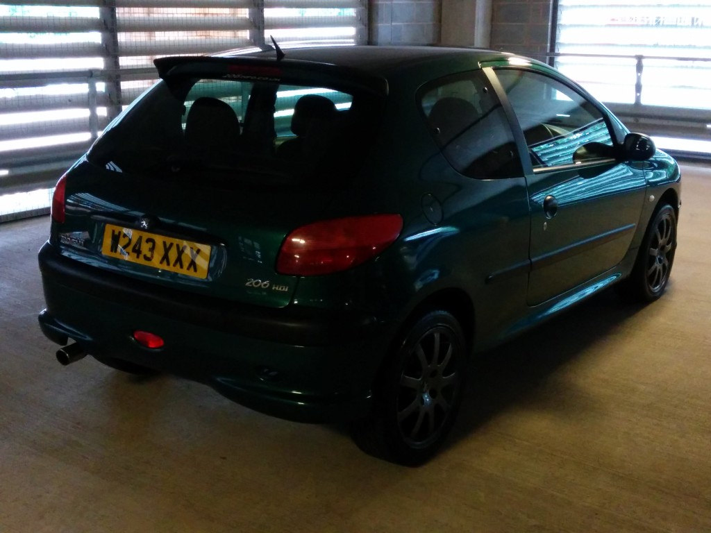

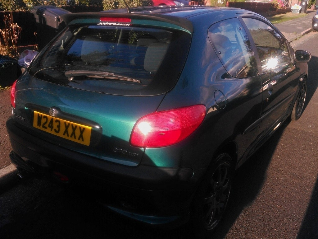

PlastiDip off
Primed (450ml £15) - decided on the day, used what's around. Using black primer is better (and cheaper)
Sanded
1st coat (400ml £6.74 satin black paint from B&Qs if you paint last minute, otherwise order from ebay cheap ones)
4th coat
Happy with that (used up 1.5 cans), could do with more sanding after each paint layer, but was in a hurry (last coat at 1am before meeting pezhdi and Andrew :DD), looks rough around the edges (literally too) but will try to polish see what happens

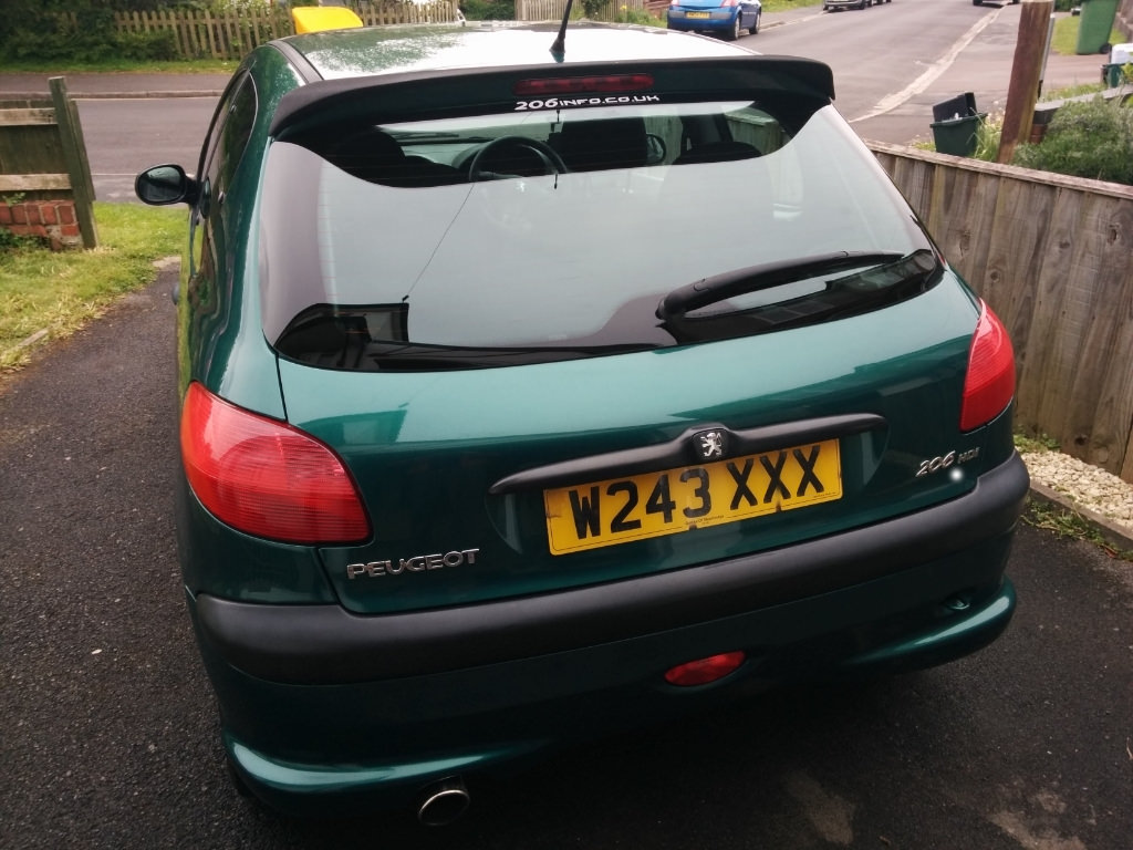

But will respray the rear spoiler either colour code or satin black just like I did to the front bumper, because PlastiDip attracts all sorts of fluff and doesn't come off without a tape

Update in need indeed!
July 2015
Paid a detailer for pugfest:
Since shocks were out, was time to rust away under the arches (they'd take 6-8 hours for a scrupulous do and this given amount of rust)
Appalling view:
Sanded:
Rust converted:
Cavity waxed:
Undersealed:
Same for another side:
Rust likes this bit under headlight surround, treat it well:
Too much cavity wax caused runs (not mine):
Used leaf blower to ripple the runs instead:
Dinitrol underseal spray smoothened it all nicely thereafter, also now with Pez's coilies fitted:
Just before the moment of truth Smile
Happy with the result
Since the front was taken apart, took a chance in attempting to sort out PAS pipes (who cares if it rains, when garden umbrella fits the towbar like a fiddle Very Happy )
Ran out of time to replace the bent headlight surrounds, so put the old headlights back, meaning I had to again cable-tie the driver's side one, but looks like I'm getting better at this, should ask for a bumper sticker from Shadowstalke "Certified cable-tie specialist" Very Happy Also very happy with aligning the bonnet and wings even more flush than before (considering car's accidental past Razz ):
Followed tips online about proper carwashing, got £1 buckets from B&Q, gritguard and natural lamb's wool mitt to avoid more swirls on a dark coloured car like this:
Here's how she looked washed waxed
Dropped at the front by some ~45mm and then straight off to Lee at FCM Wheel Alignment, best specialist in Bristol:
