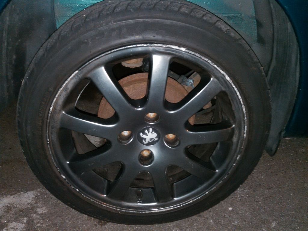

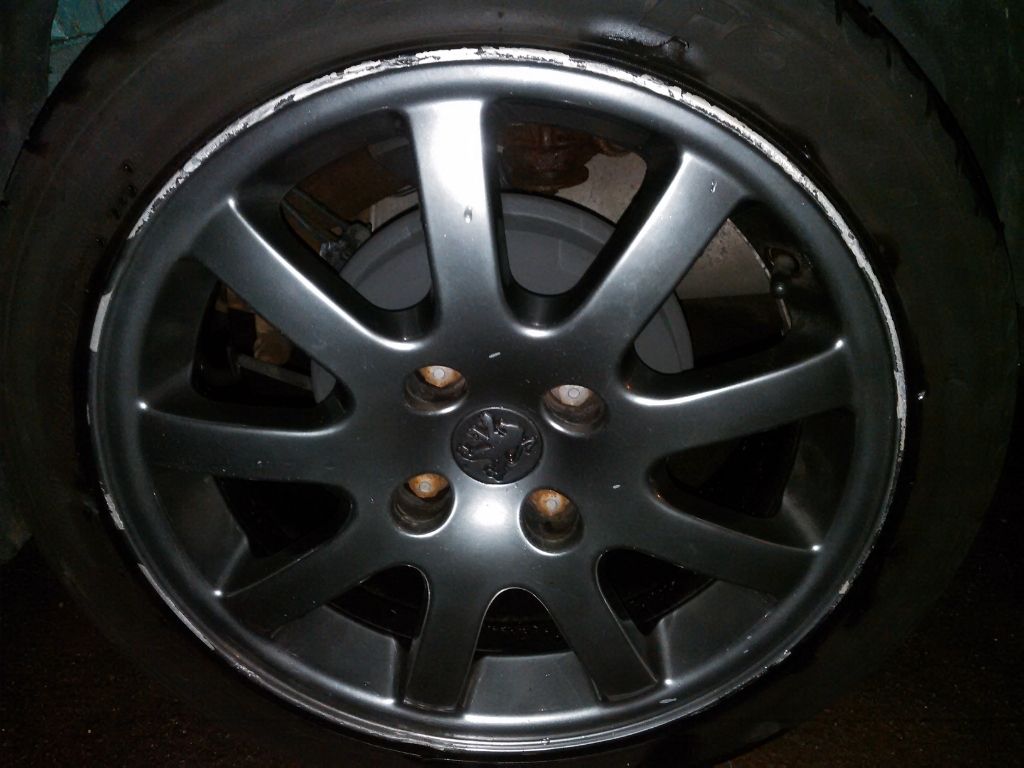

Finally swapped 207 15" Monacos with Andrew's 16" gunmetal grey Nimrods
Plan to refurb and repaint them same silver colour as Monacos

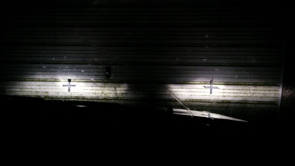

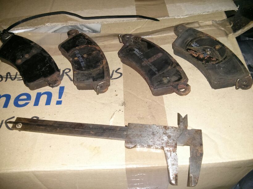

MOT is sneaking up, time to aling the headlights as youtube instructed:
Fit some nearly new pads I salvaged years ago
Had an unfortunate buckled wheel hub back then, which kept on warping nearside brake disks. It cost me a couple of pads'n'disks replacements until I found the root problem. Had a gut feeling to keep these pads, and voila!
Made sure to copper grease metal2metal touching parts, and never heard a squeek from them! (previous pairs squealed like a pig..)
Had just a day to replace pads before the MOT re-check! Working in cold...

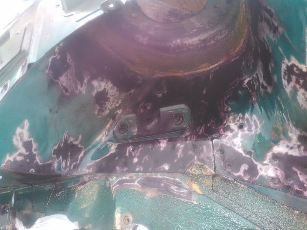

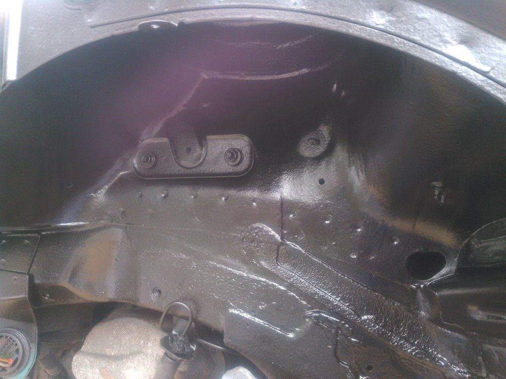

April 2015:

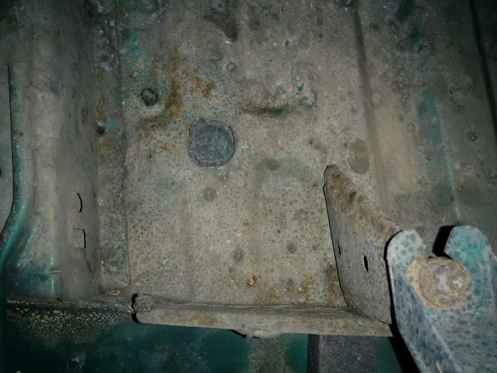

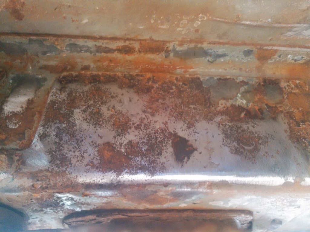

Project "Rust Away" in motion (yes, you can read it in two ways Razz ), some before/afters:

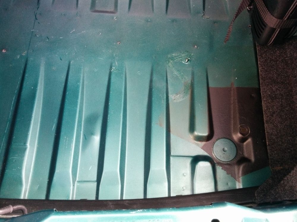

Was mainly testing Dinitrol underseal kit, will need to attend more corners in the boot where an ex owner drilled through for their sub Smile

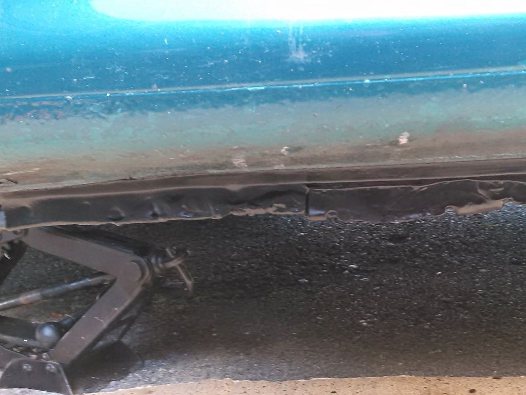

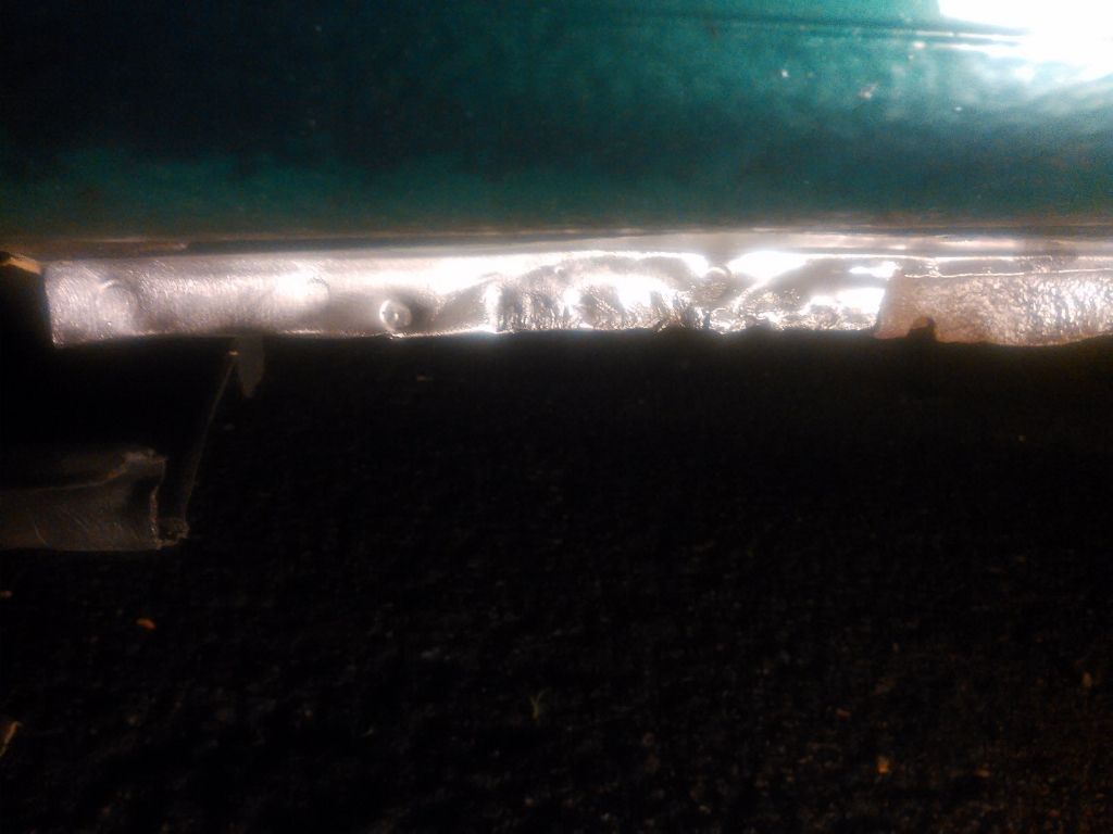

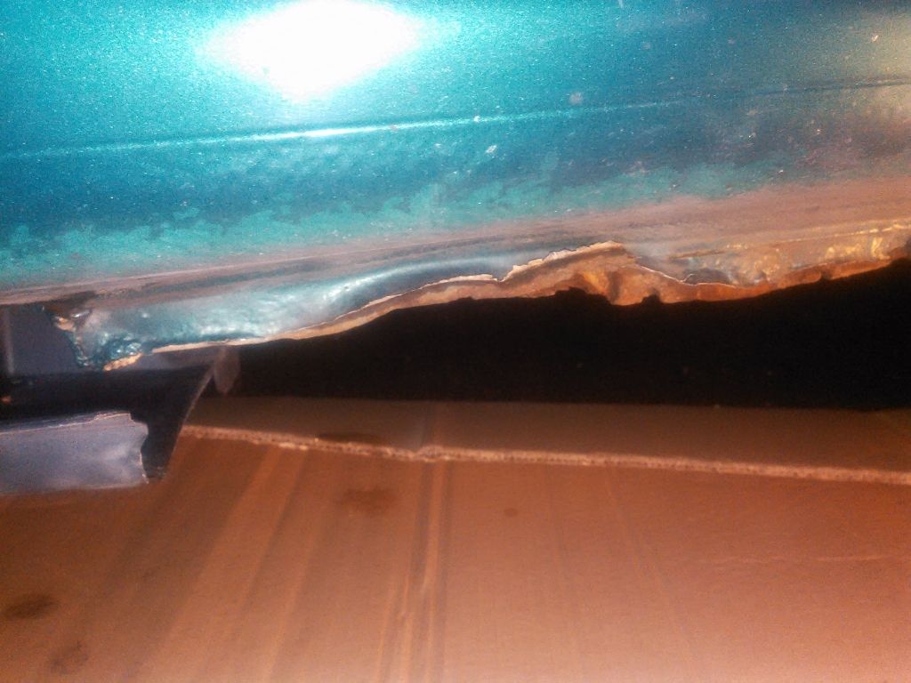

Jacking sill repair (warning: never let your friends jack up your pug. Some of them simply may not know where jackpoints are, some of them who prefer another car maker, might do it on purpose to falsely show how fragile your car is and make you jump ships Very Happy ):
Applying Dinitrol undersealer kit on the jacking sill was a risky thought, but even after careful jacking up on rubber hockey puck, the scratched marks heal themselves - the power of Dinitrol!
Lots of work ahead:
This one poses most worries, will attend it with pressure washer ASAP to see how bad it really is:

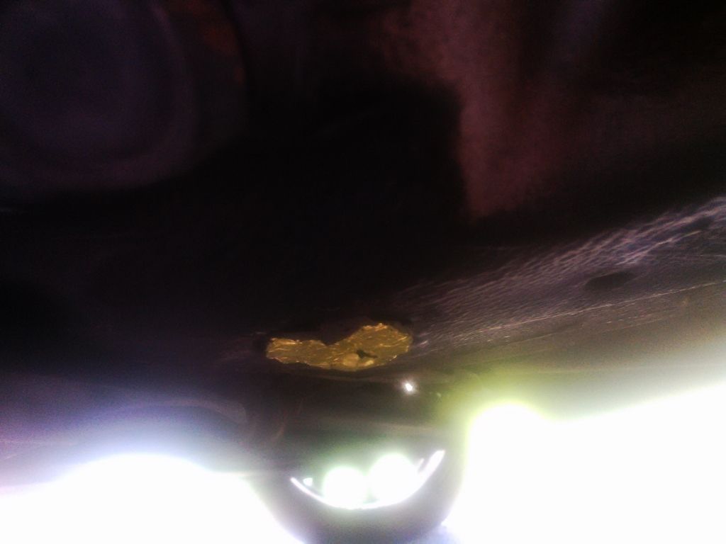

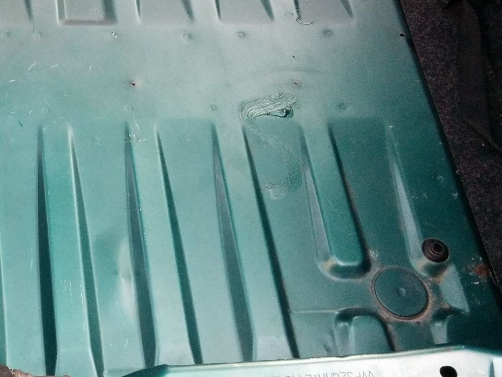

Cured a patch underneath, we'll see how it behaves once exposed to the elements (UPDATE: months later some rust did come back through, will need more thorough treatment):

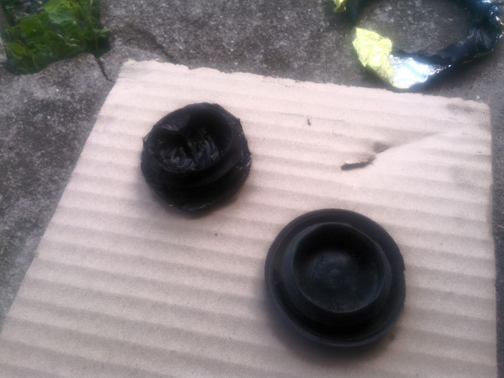

One blanking cap was a dud, so I dabbed it into a blob of tiger seal, it will do for now
If it s(h)its it fits Smile The yellow foil was from an easter egg that I dabbed tiger seal on. Got glued so I stuck with it (will try not to cross border where they inspect under your car with an angled mirror :D)

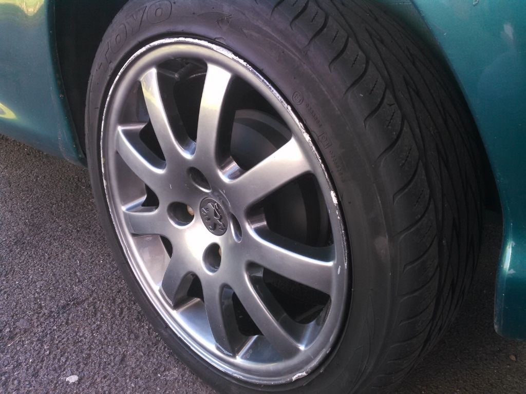

If leave the wheels that colour mate they set of that paint off lovely just needs lowering a little Smile

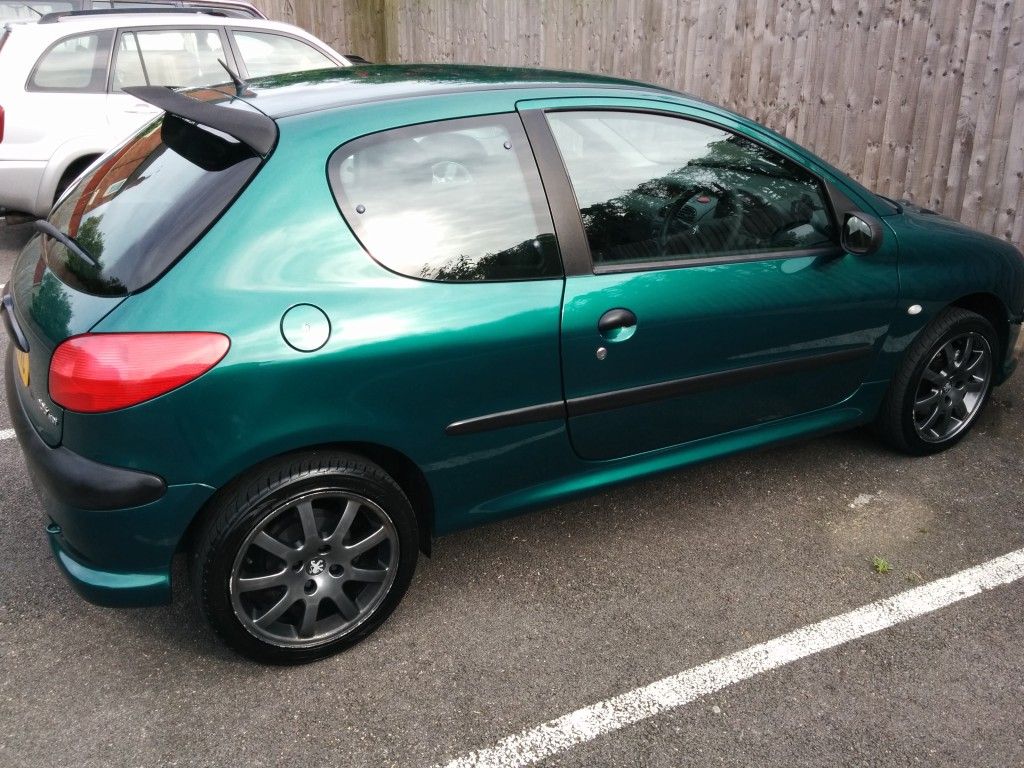

Yo bro, good to hear from you! Yes she needs lowering, but I want to get it right rather than get it done Smile
I know it's far from MattyP's lush'lloys Wink but I do miss the shiny Monacos: to my mind they went along with headlights and side indicator (see my avatar pic). I won't tint/change them headlights, as the goal is to keep it OEM clean.
After some photo editing, rate it or slate it Very Happy

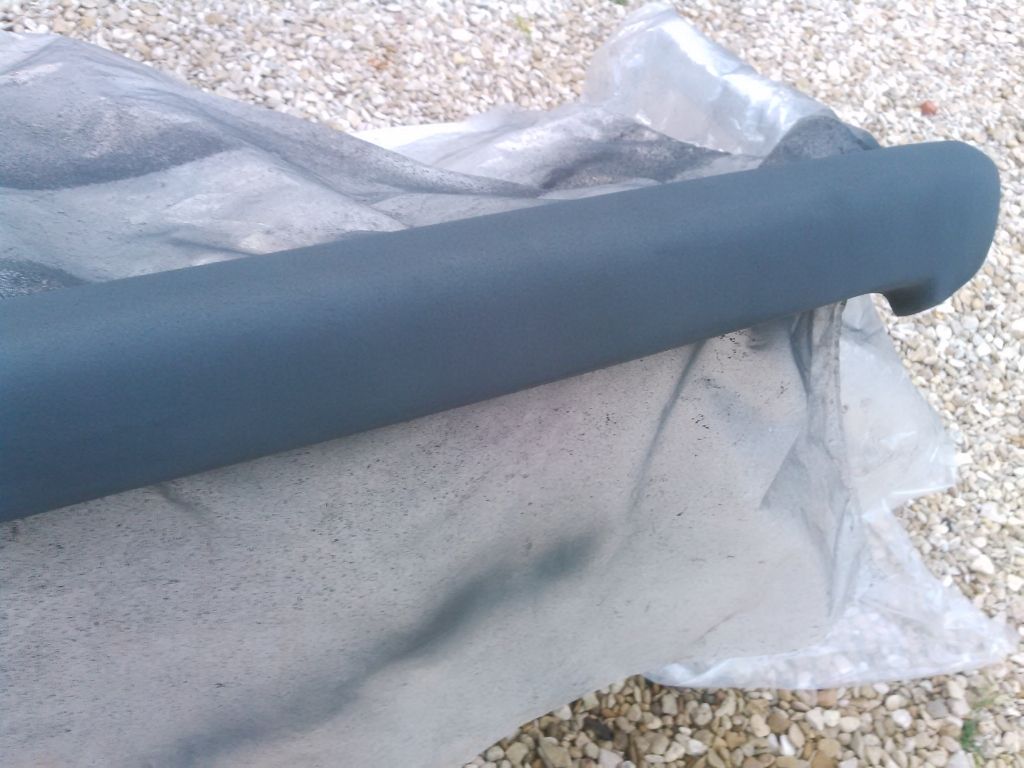

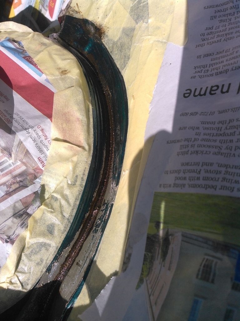

Came up with completely new idea about alloys. Will see how it pans out.
In the meantime these dropped on the doormat this morning,£5.98 each from fleabay:
Thought about pressed plates, but all of them have that ugly coachline, whereas this project is going for the clean looks.
The old ones've become somewhat opposite of clean... Shocked

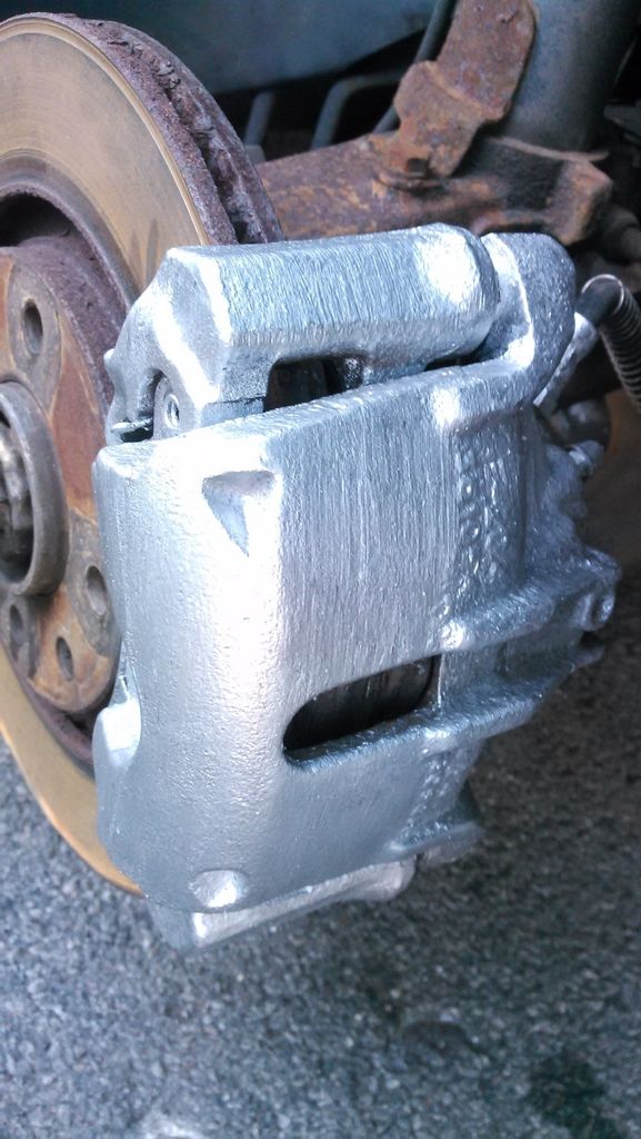

Progress cpl of last months:

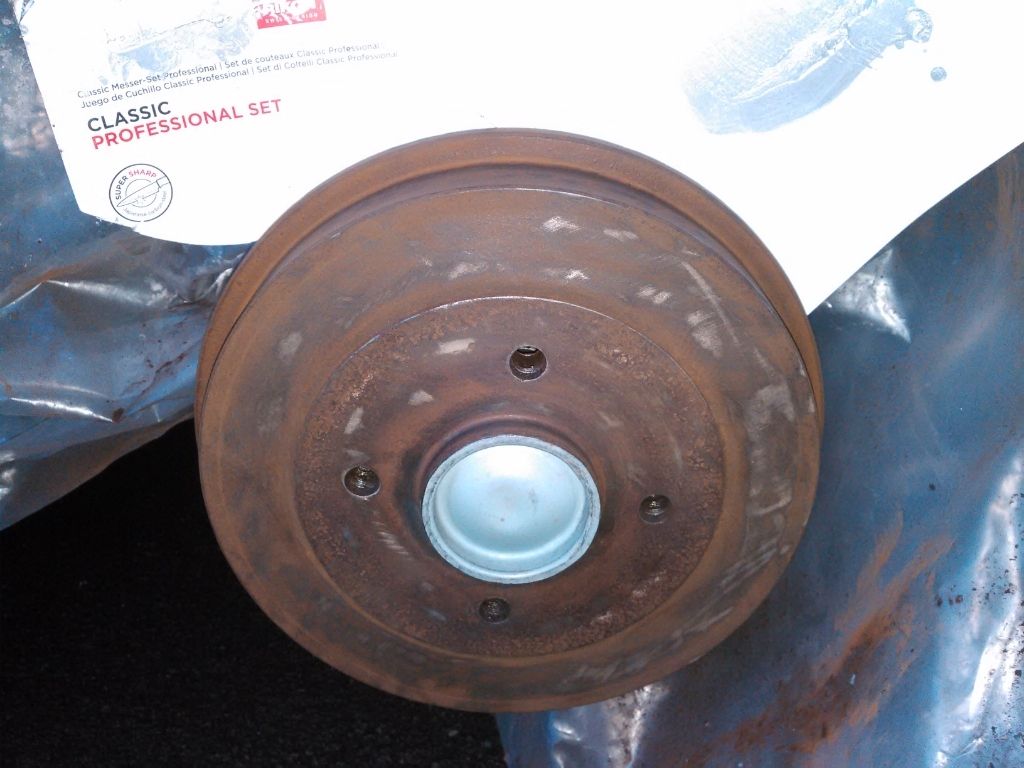

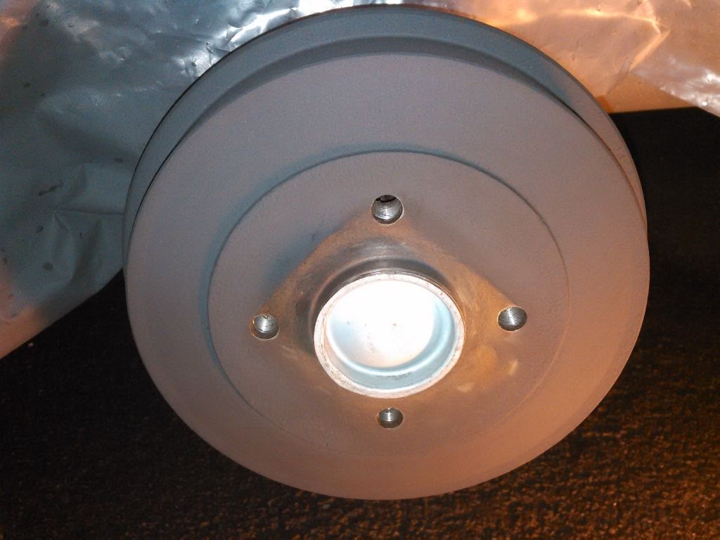

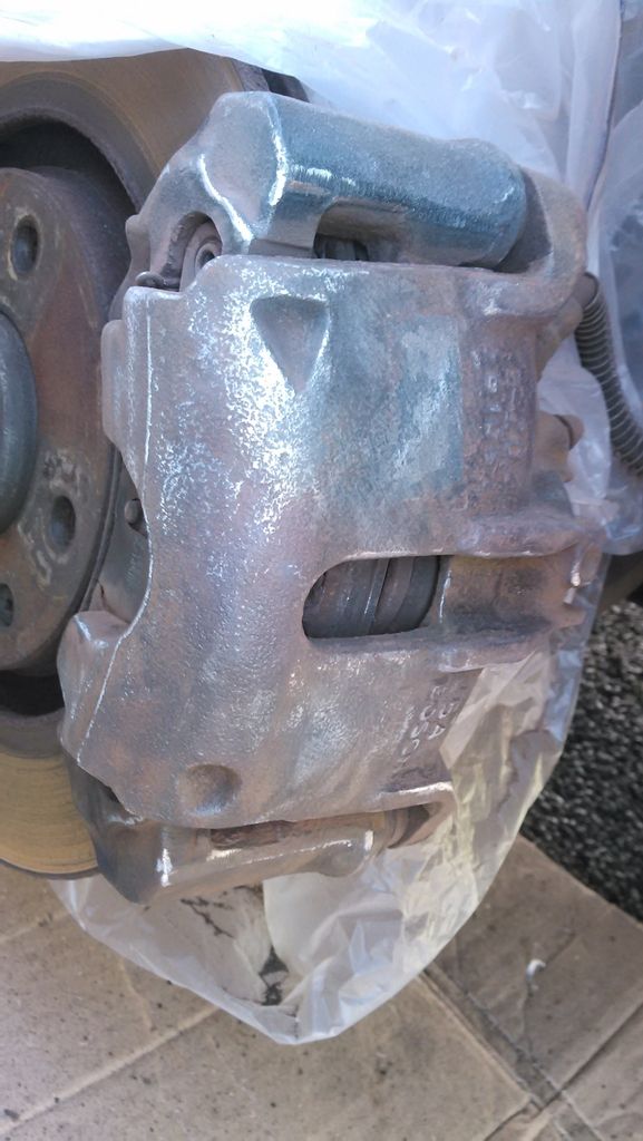

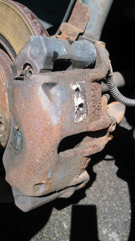

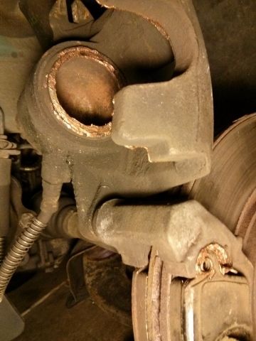

Caliper (400ml ~£7 spray still remained) and drum do:
Wirebrush drill bit, flappy sandpaper drill bit, less elbow grease
Cheapest (500ml for ~£8) black paint Hammerite type turned out to be grey Sad but I like it! Very Happy

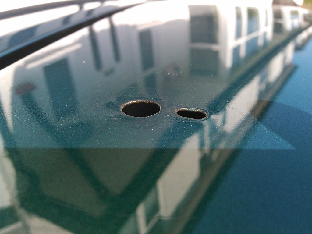

Old aerial base was seized up everywhere, sourced new one and a stubby - fleabay might sell you both for ~£17 (or ring up pug dealer)
Now reception is crap Sad will go for A-pillar aerial; so this will stop scrubbing the spoiler and only for looks if you can't be asked to smoothen out the two holes What She Said

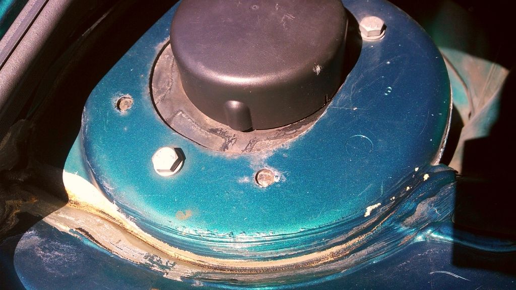

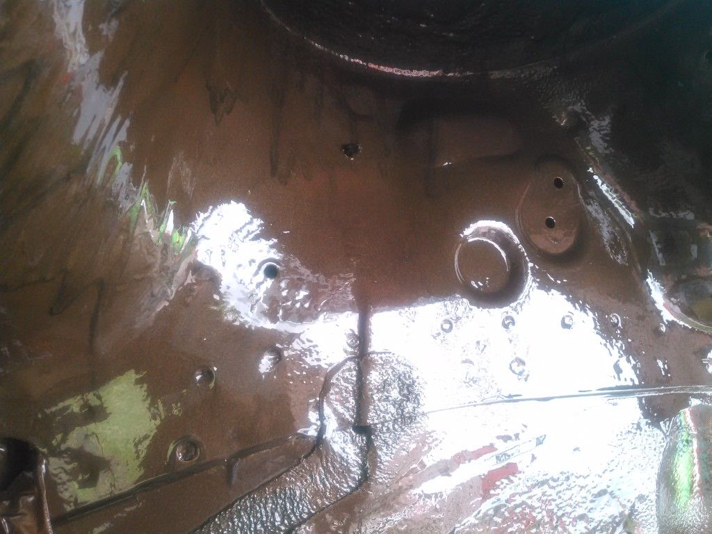

Running water eaten off paint and more over the years around top mount tower:
Got liking of spraying Dinitrol combo everywhere:

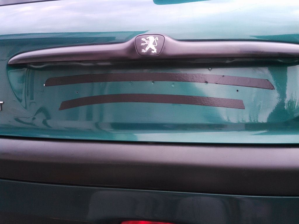

Finished with Tiger Seal and Dinitrol Underseal, will also clear coat for dust not to stick.
Road illegal haha
Double-sided tape with slant for water run-off and extra thick on the top ends as boot has a slant -- holds to date
Happy with that Very Happy

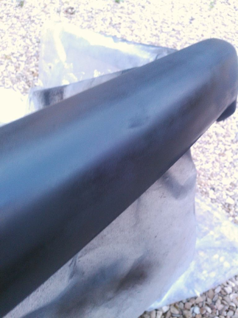

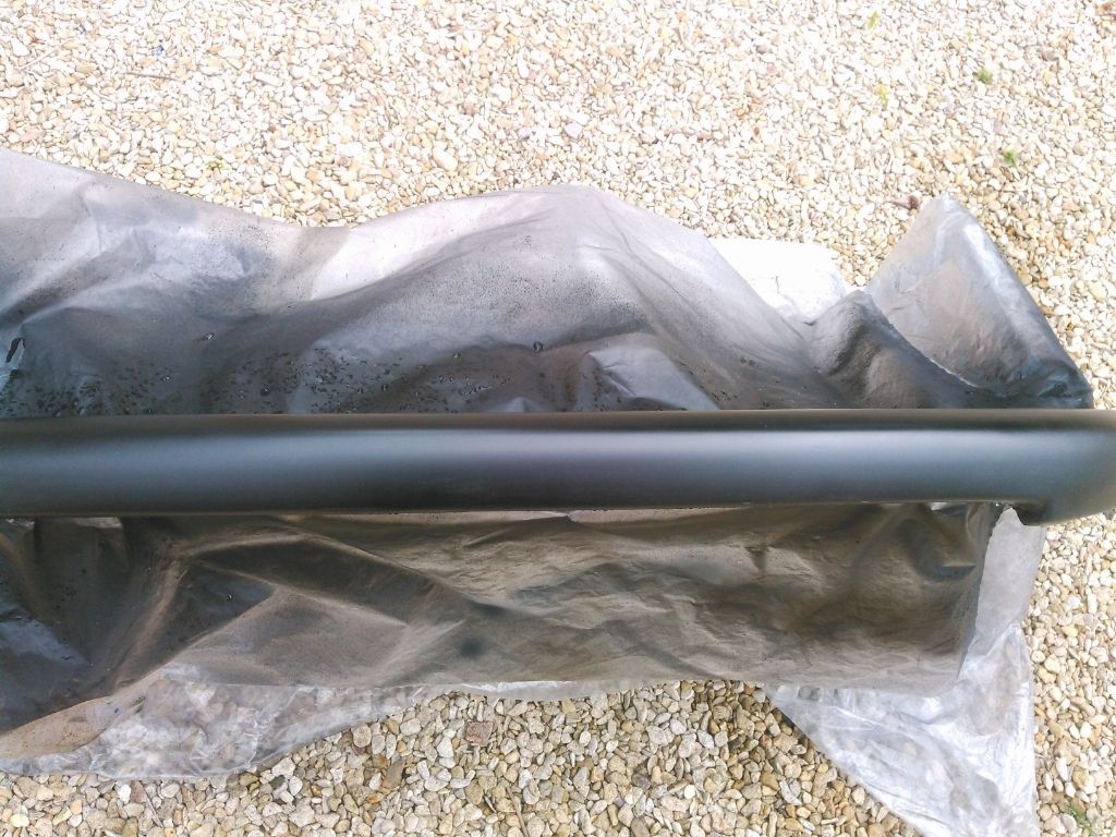

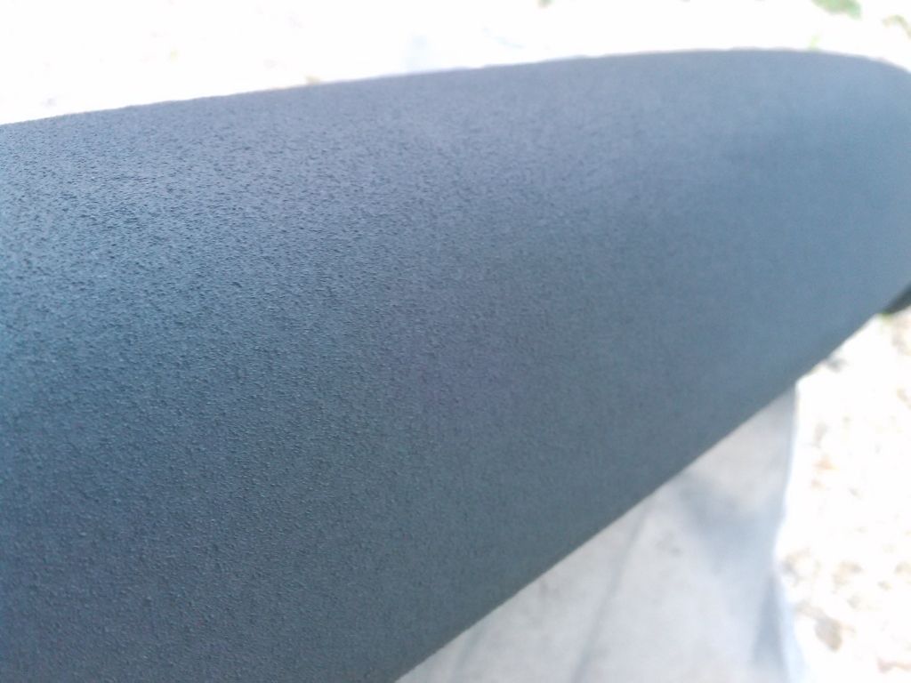

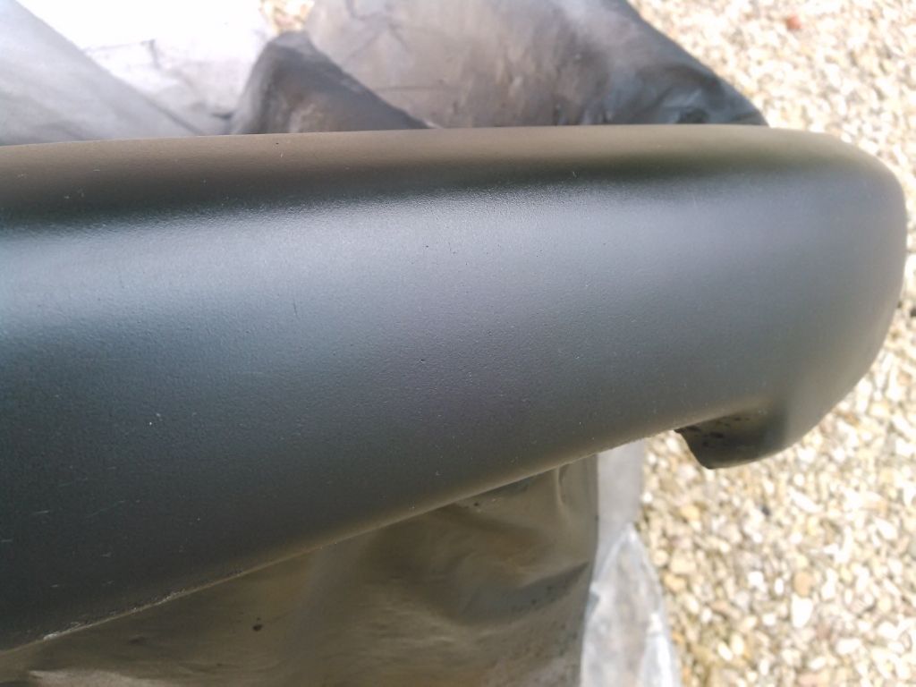

Won't replace front numberplate just yet, first have to deal with bumper having reacted with old paint (bad prep) and bubbled out under fogs

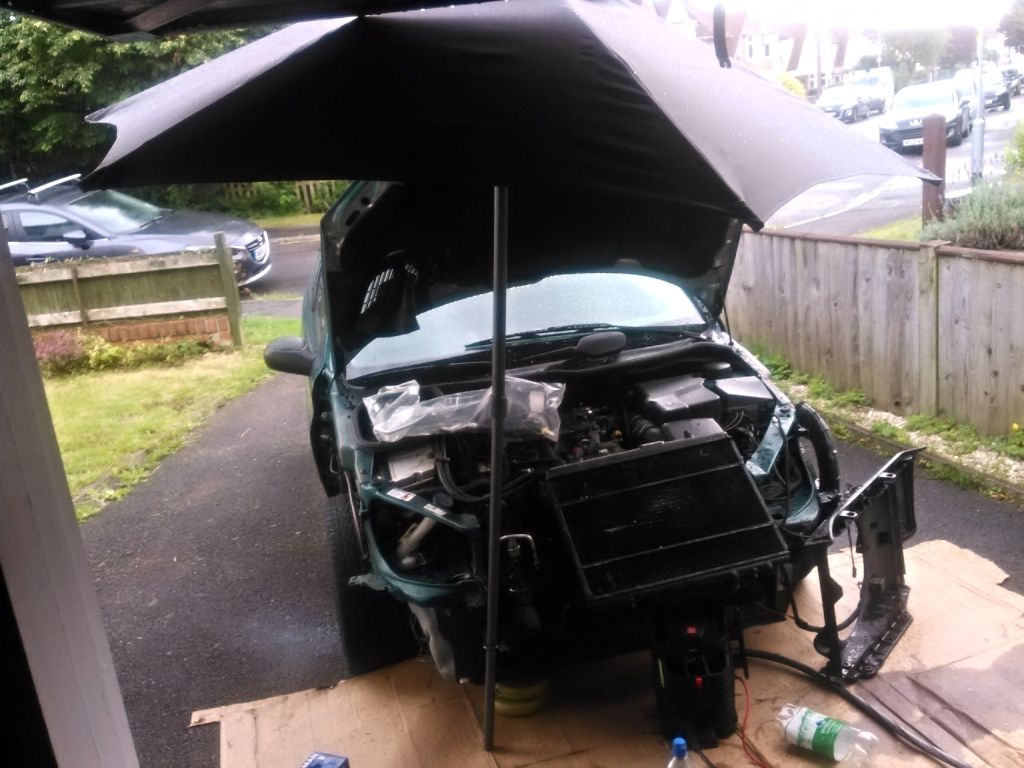

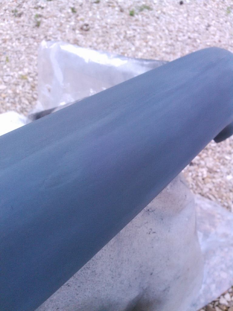

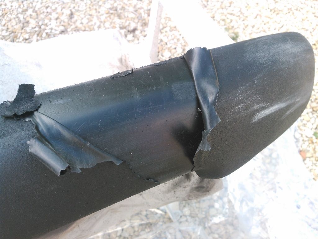

Bumper do
PlastiDip off
Primed (450ml £15) - decided on the day, used what's around. Using black primer is better (and cheaper)
Sanded
1st coat (400ml £6.74 satin black paint from B&Qs if you paint last minute, otherwise order from ebay cheap ones)
4th coat
Happy with that (used up 1.5 cans), could do with more sanding after each paint layer, but was in a hurry (last coat at 1am before meeting pezhdi and Andrew :DD), looks rough around the edges (literally too) but will try to polish see what happens
Peace out! Next up - pugfest and lowering Rock Onnnnn..

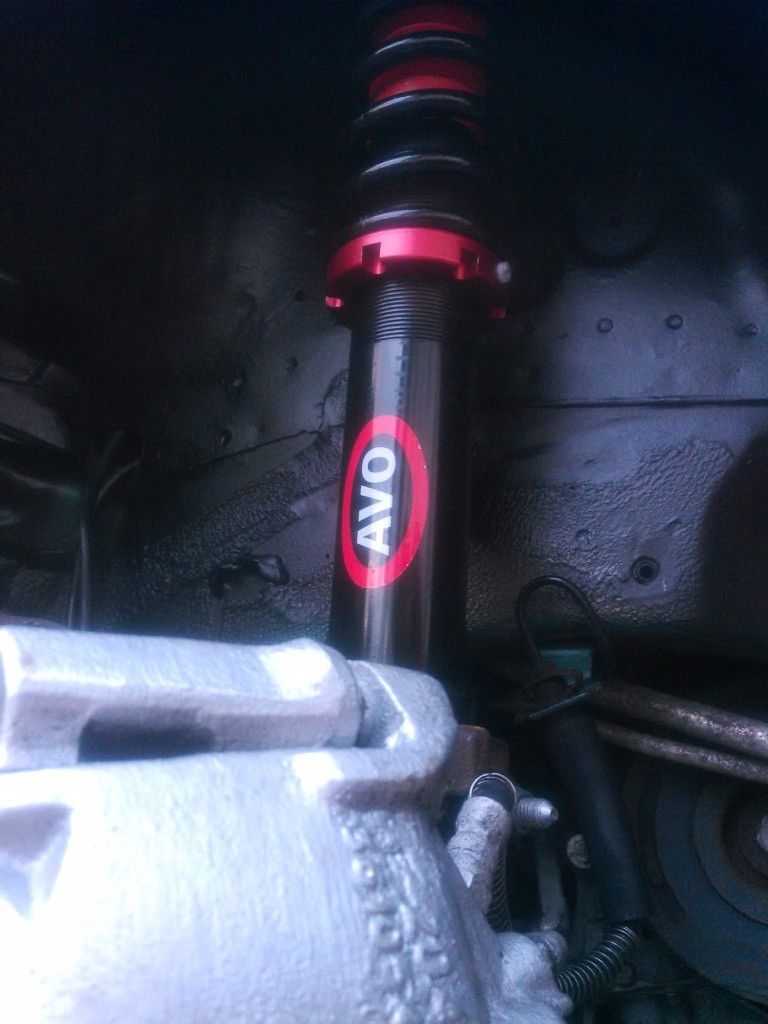

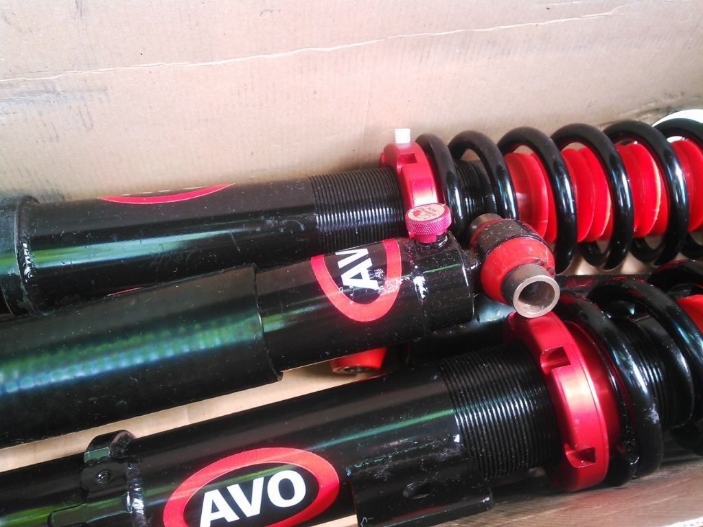

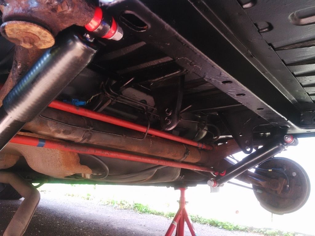

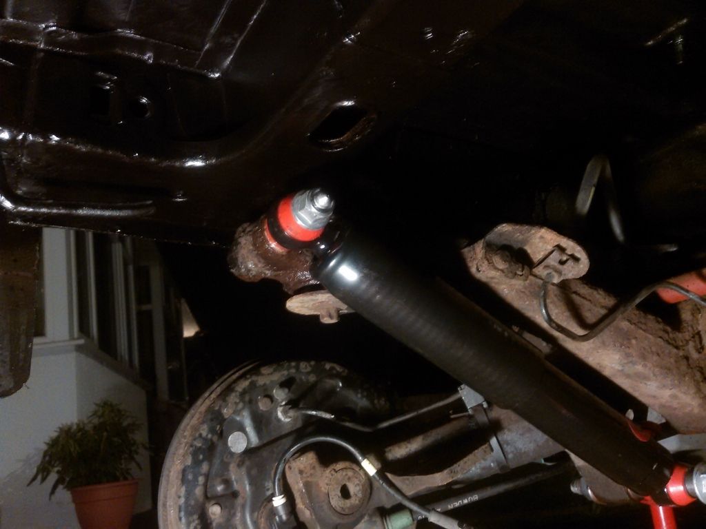

Short update, applied underseal and fitted pezhdi's rear AVOs shocks - amazing how she sits now! More experiments with damping to follow, will report here
Whole week wasted (but what an experience!) in trying to knock out dead-seized torsions bars, short story in the talk forum, will follow-up long story here later on.

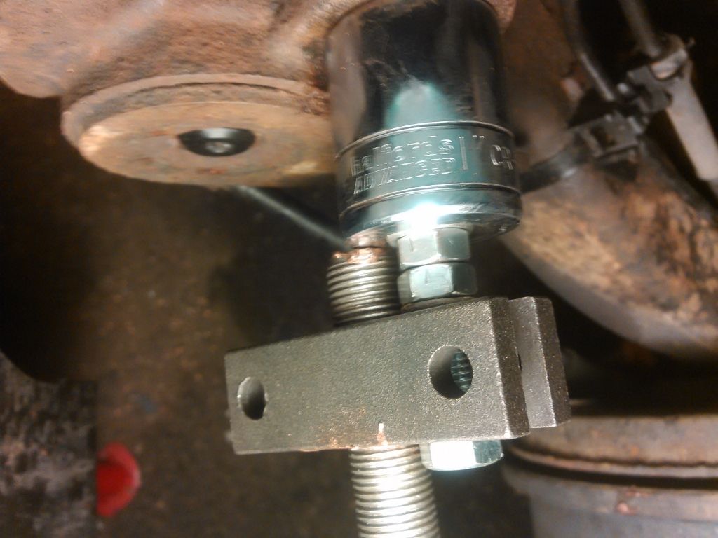

June 2015

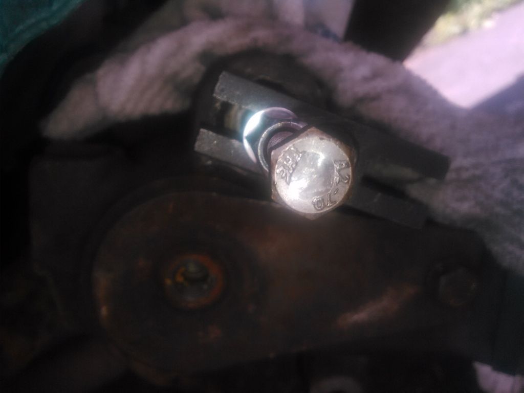

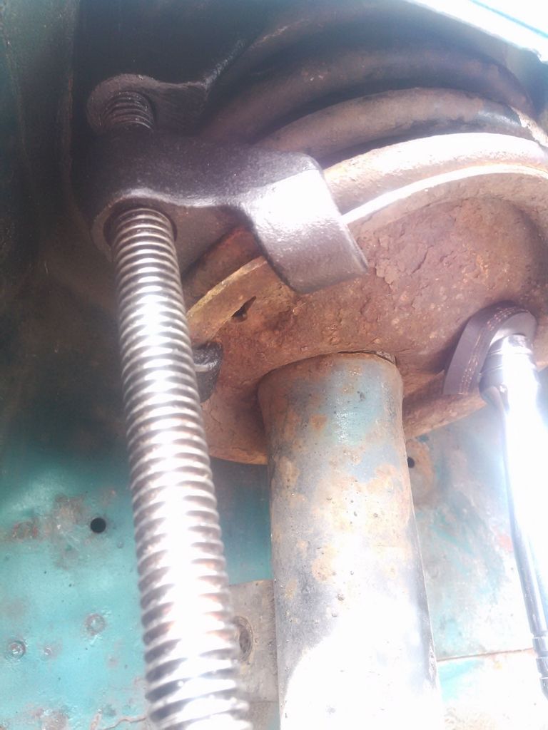

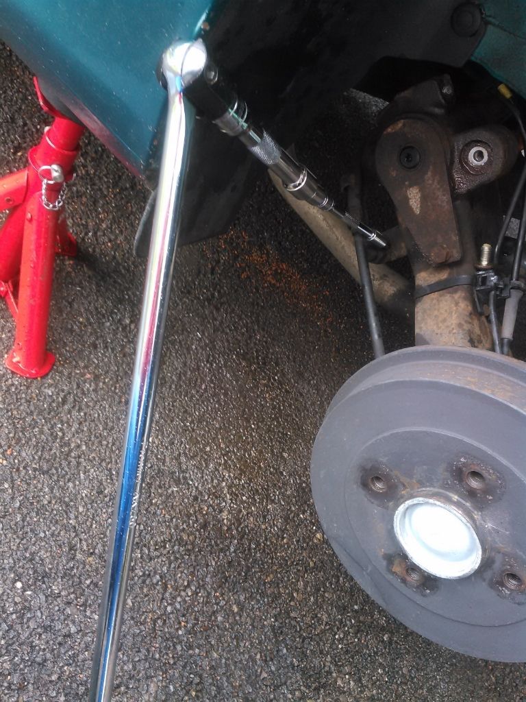

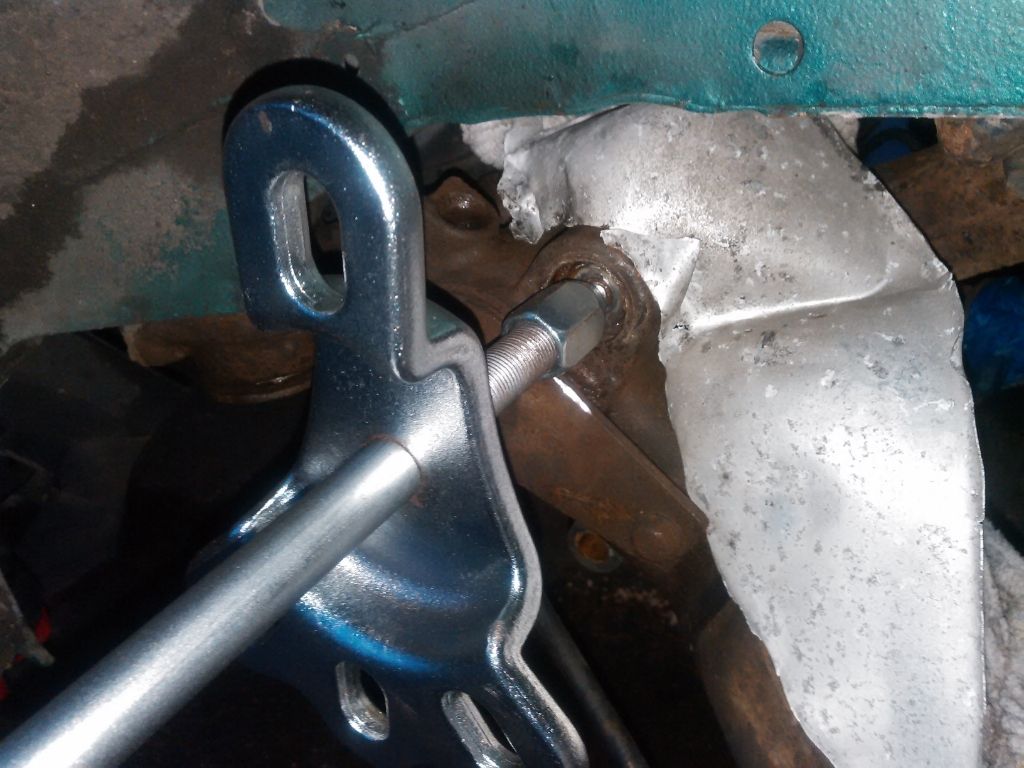

Project "rear lowering":

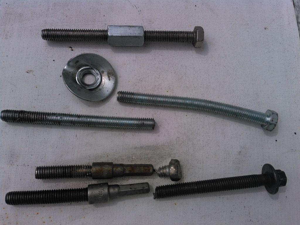

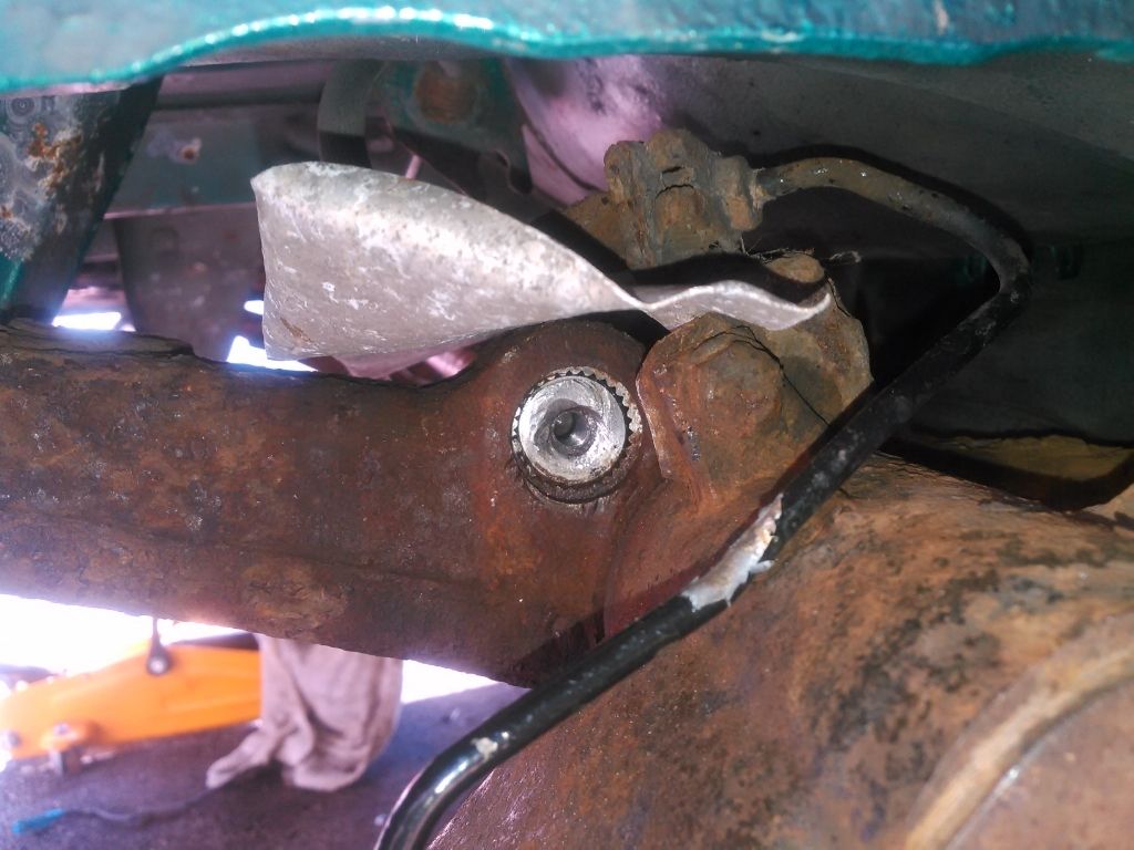

Was well happy when torsion bar torx bits just pop-twisted and didn't null the star at all!

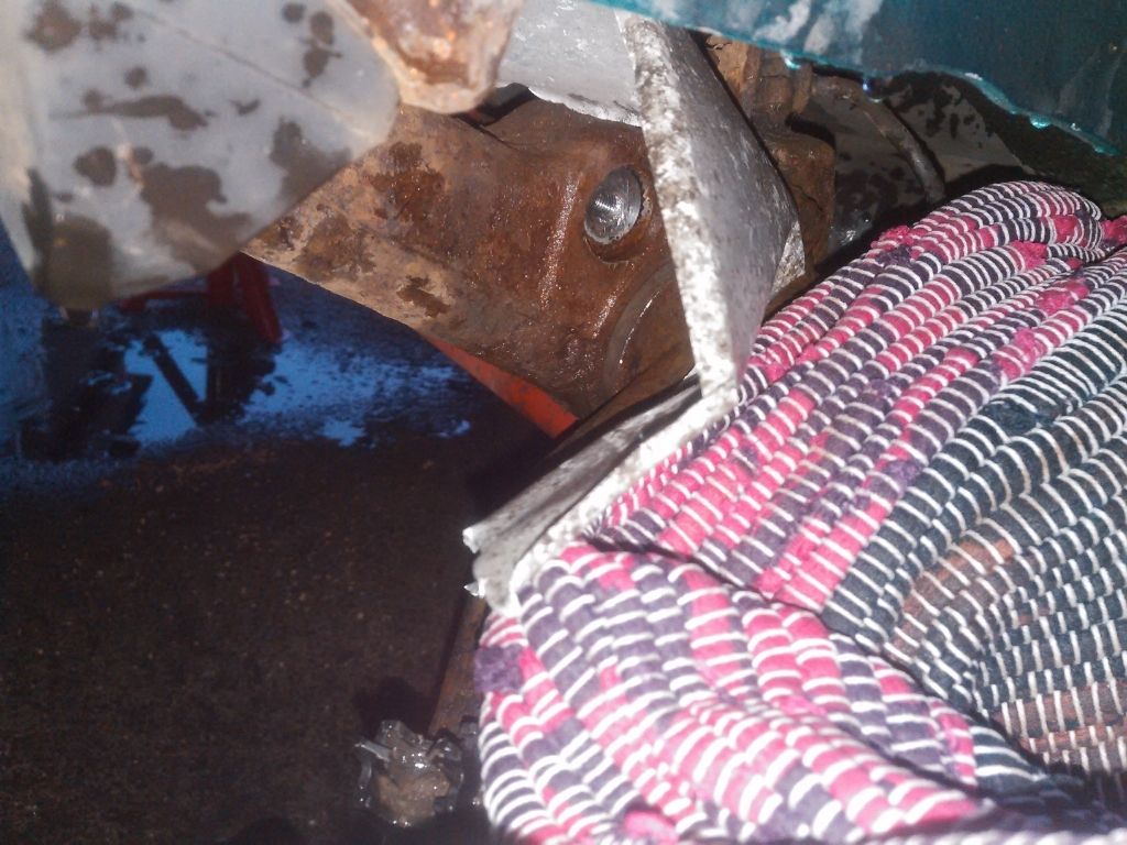

But that was just a beginning of nightmare on Elm road. Got slide hammer, mounted as much mass on it as possible, bars were still stiff:
Tried to leverage out - nada:
Try to torch it out - nothing:

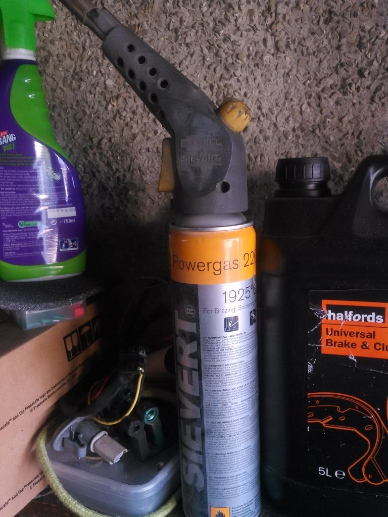

If you try this at home, at least cover brake lines with soaking wet towel
Mate calls me a hoarder, because I keep all sorts crap in the garage.. Well back at you mate! This random 307 tank aluminium lightning shield has come finally handy!
Nope, not even skin of teeth it moved (also watch out for brakelines better next time!)
Last resort of extraction bracket and 10.2 strength bolts - they gave up either (even when I was sledgehammering from another end, after torching for 5minutes. BTW did I mention that this flipping torsion bar thing was soaking in plus gas for the whole week and didn't make its hole weak!?):
The verdict speaks for itself, gave up on this granny axle; a recon on is in in plans now (one good thing - at least will be able to do conversion to disk brakes as well):

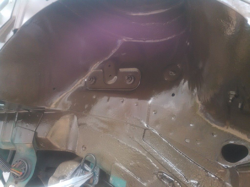

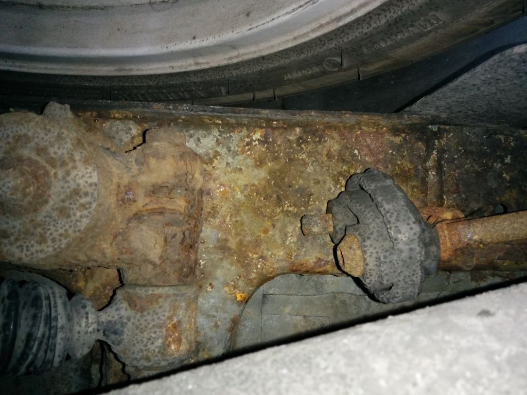

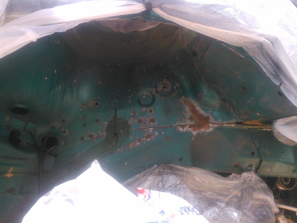

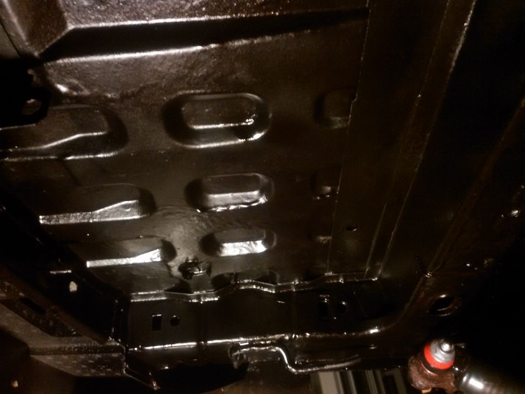

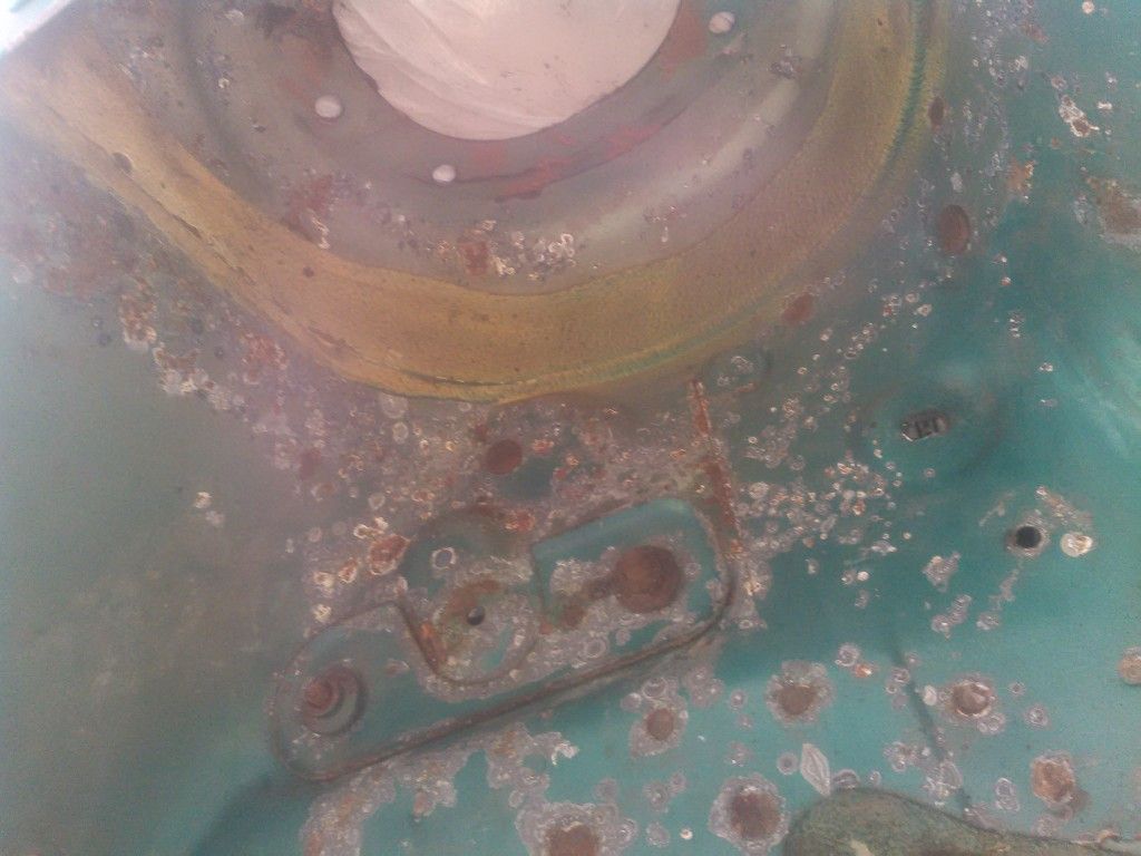

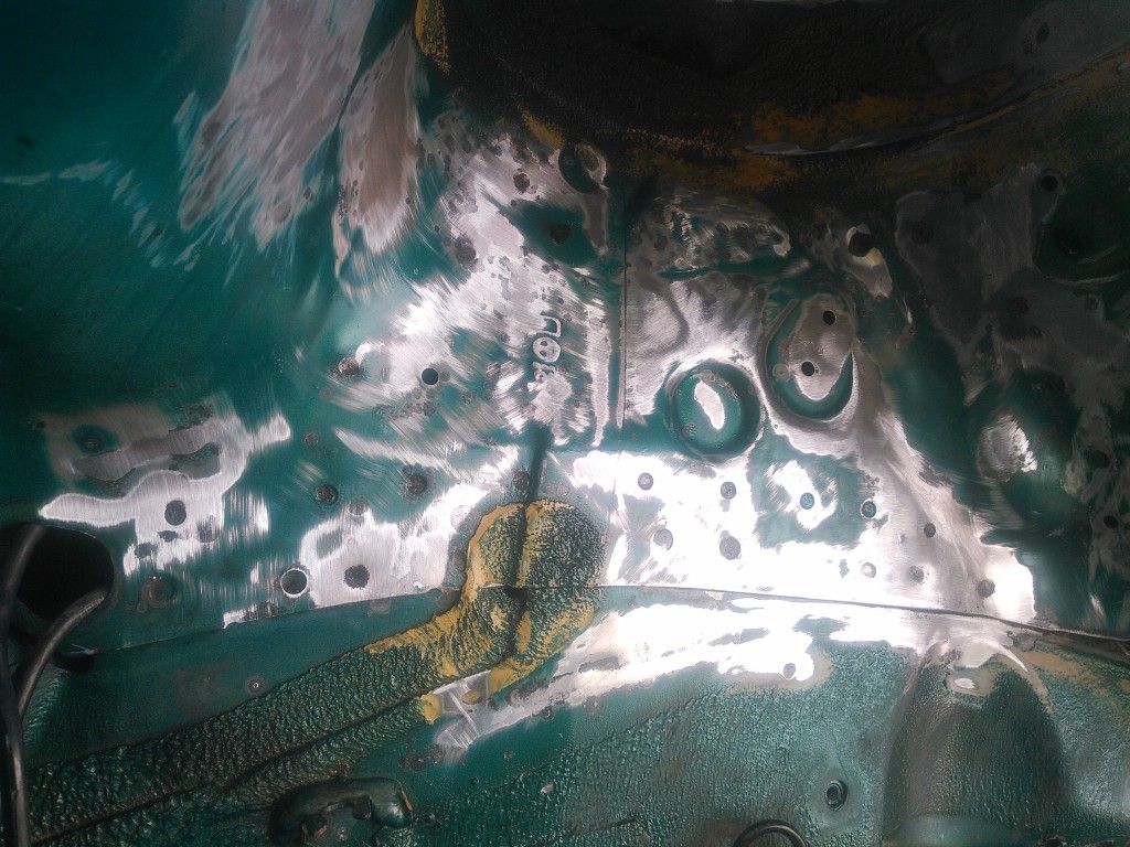

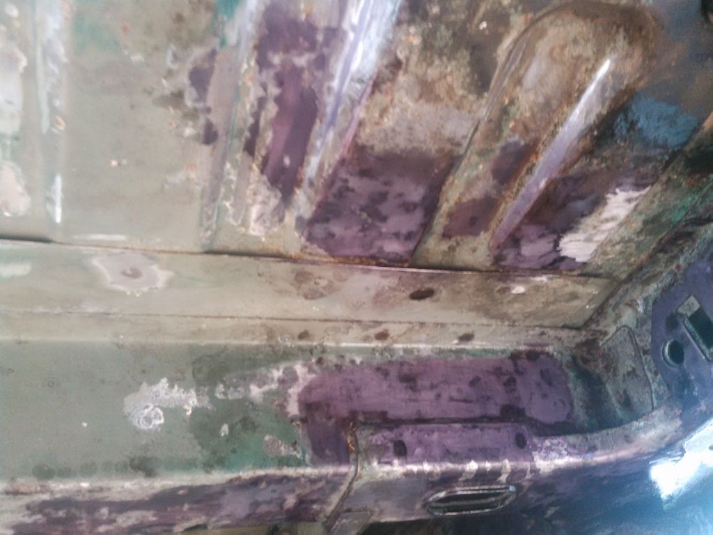

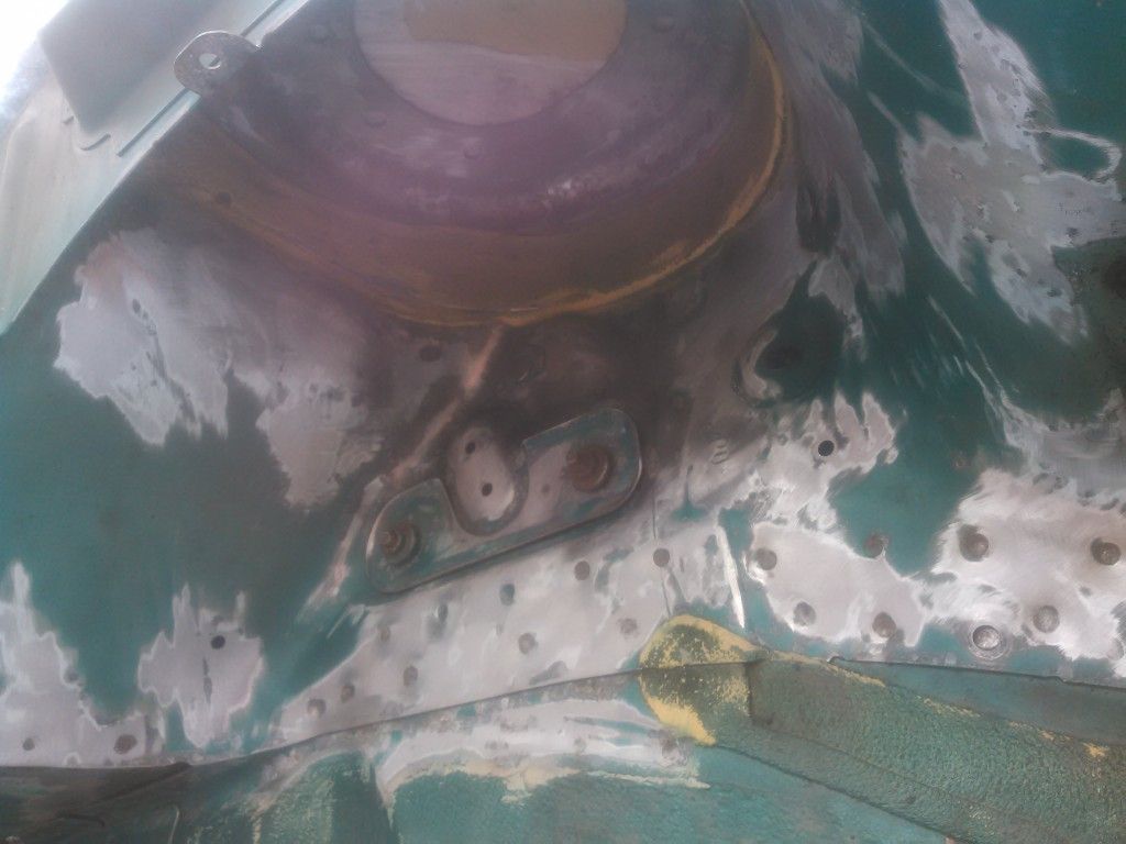

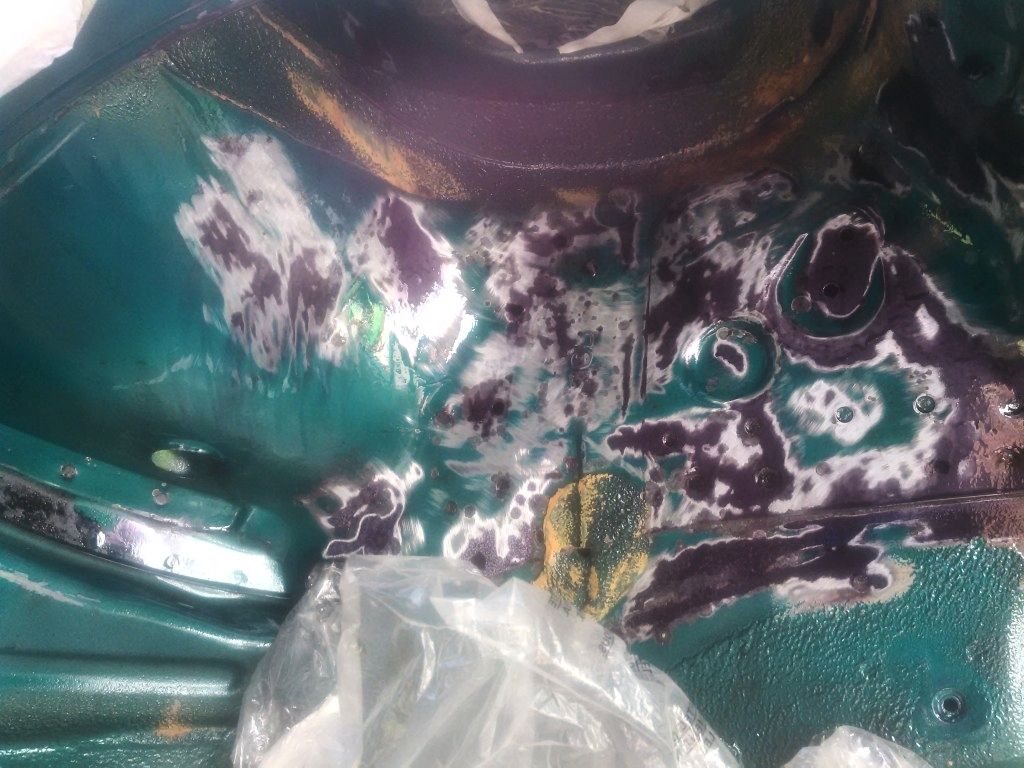

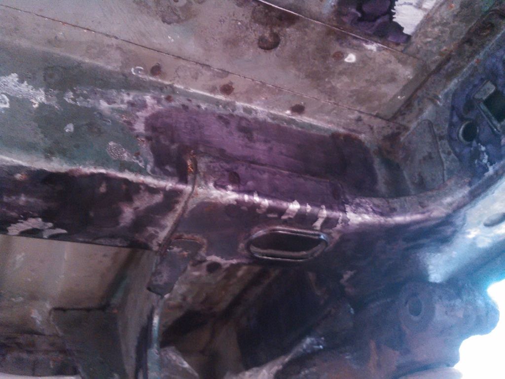

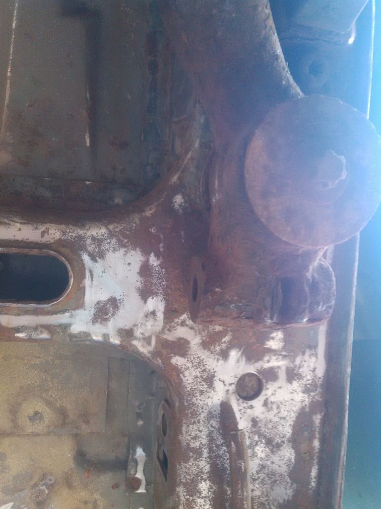

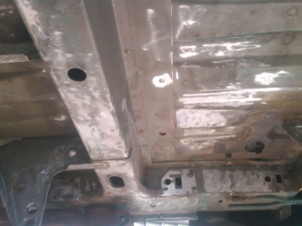

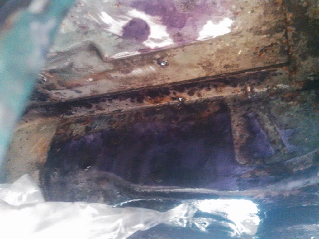

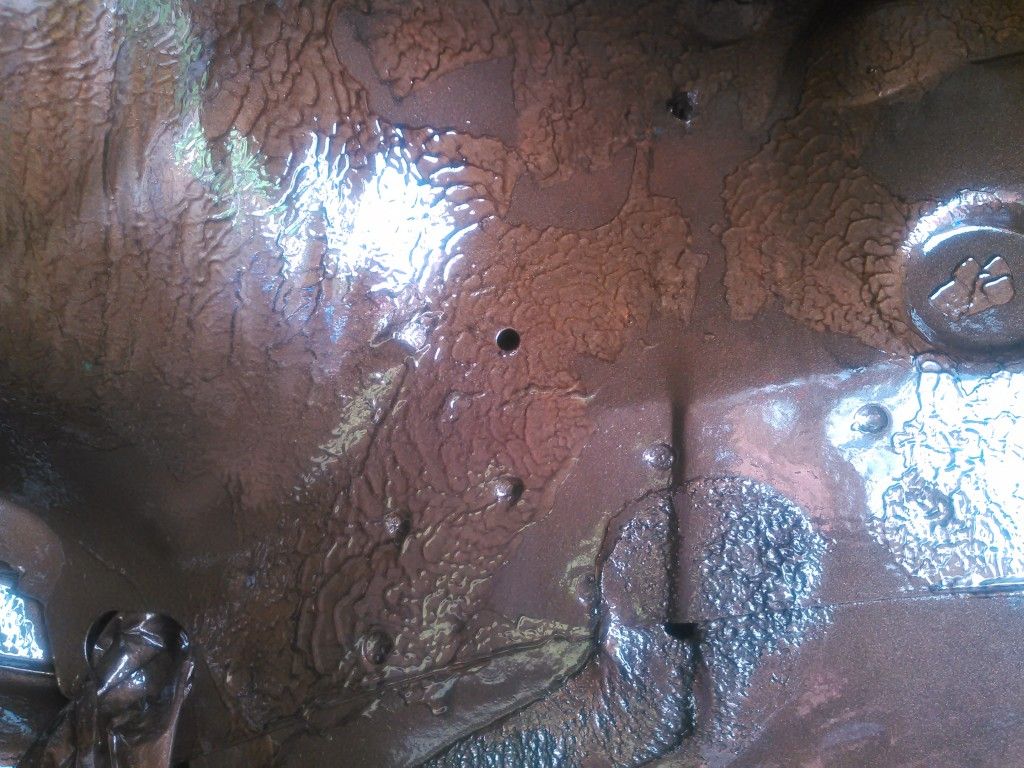

"Rust away" in action.
Sequence:
  • User pressure washer to get dirt and loose rust off
  • Wait to dry, then use steam cleaner to get more rust off
  • Use wire brush to wipe out yet still dangling loose ruse (don't brush too hard or you'll just press it into the metal)
  • Sand it, i used flappy sandpaper wheel drill bits, wear face mask
  • Air blow rust dust out (no need to make everything wet again, especially on exposed bare metal)
  • Put Dinitrol rust converter, all remaining rust in crevices turns then black inert iron
  • Spray cavity wax everywhere (it has more of that convertor, and stick everywhere)
  • Finish with undersealant - that one never cures hard and will keep painting your face everytime you're under the car, but worth it, as it's self-curing from the chip damage
Not super happy with initial rust removal, many places I could have done with extra elbow grease, and did a bit hastily as pugfest was climbing on my nose:
(See "before" photos in previous post)
But I leave for Dinitrol RC900 to finish the job:
Undersealed with cavity wax and black spray, some runs, but this can be adjusted, as it never cures to hard anyway
Shiny Pez's AVOs <3 Twisted Evil
Happy for now, let's see if/when rust comes back through

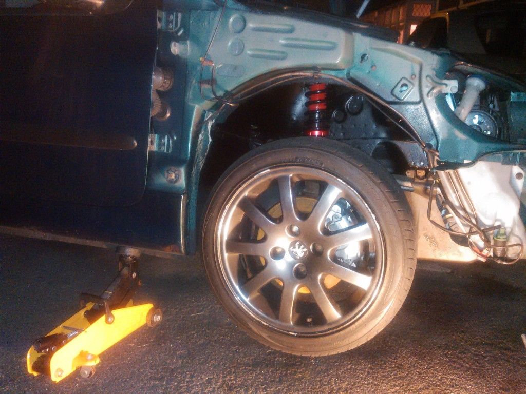

After feeling how awesome stiffer shocks are at the back, can't wait to fit AVO coillies at the front too. Gutting commenced:

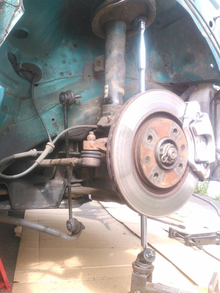

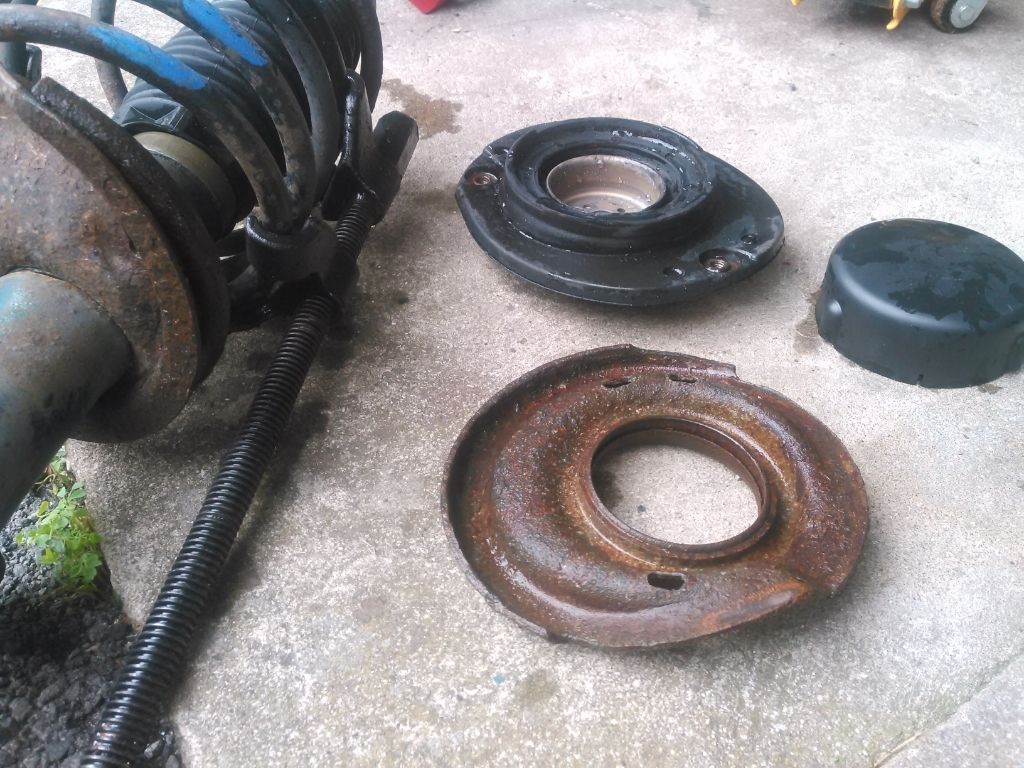

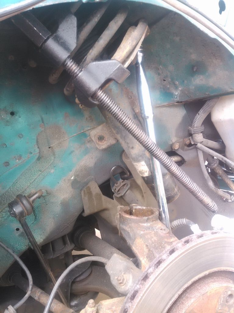

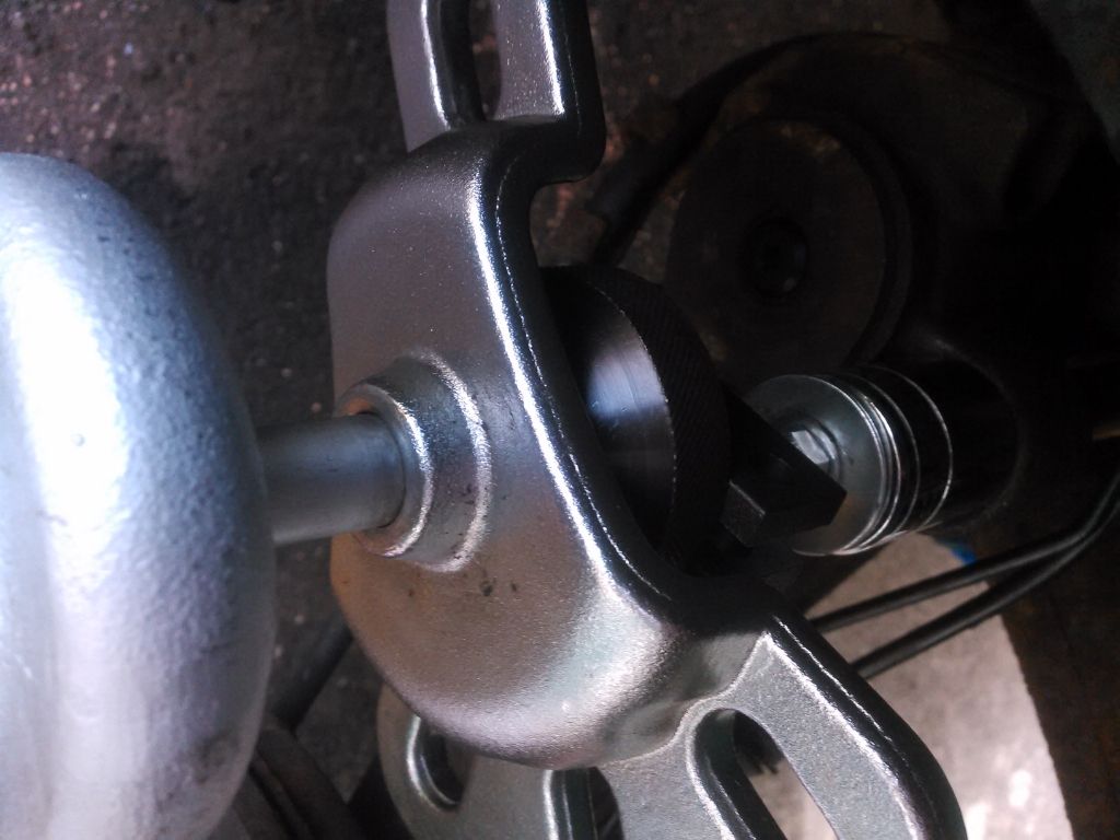

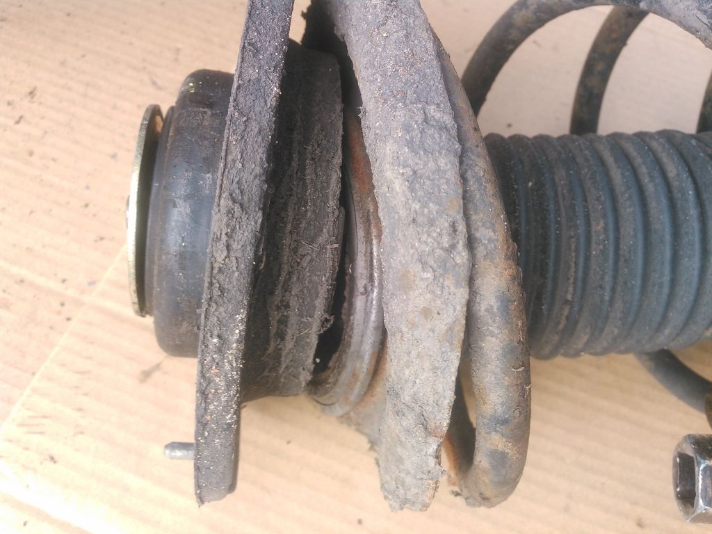

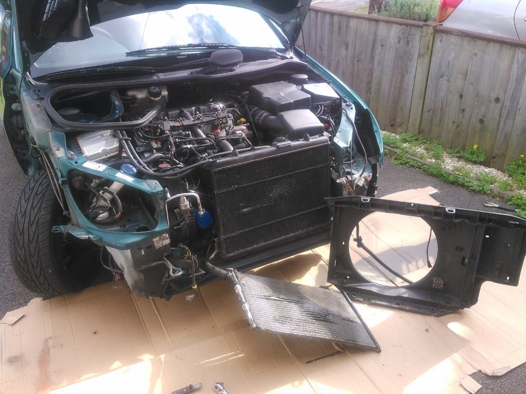

How to take the shock out from the strut without popping ball joint
(DISCLAIMER: NOT THE SAFEST WAY OF DOING THINGS!)
This might involve removal of front wing for better access for securing the process with spring clamps, so better do that when you have other things lined up for your car too.
Especially polybushes make it much harder to lever the wishbone out, so I try to avoid splitting balljoints as much as possible, also the following method is done with only one pair of hands:
Do the usual (undo droplink, then pinch bolt, pry it with screwdriver, spray some WD in rinse repeat etc like in this HOW-TO)
Then jack the springs up by using a bar of proper length (my breaker bar was too long, so I raised by brake disk first with another jack)
Secure breaker bar with with rubber pads and raise as high as it goes (look for it not to slide out, and use crease in the spring bottom mount plate):
Once spring is really compressed, you'll find a gap to push spring compressor clamp through, for extra security (you won't need to screw the top of it which is inaccessible anyway, just mildly fasten by turning the threaded pole):
The lower arm should now be parallel to the ground. Then keep hammering the strut (metal block behind brake disk). I used a long bar from the top and hammered its end, so I don't have to stand in front of wheel arch in case breaker bar pops flying out (hence the unsafe approach, a proper vertical hydraulic jack would be better, still not perfect)
The weight of strut, hub, caliper, and disk will help you and youll see them sliding down with each hammering (if you WDed it all properly). I think my ones never been prodded, so 15yearold shocks looking well and sliding down like through butter!
Eventually it will all pop out (even when you think there's still some hammering left!), it should pivot its way to the front of the car
The top mount bearings will tilt out of their rubber sockets, but no damage whatsoever
If something has not been secured well, this final popping might end up with breaker bar shooting across the yard, so use at your own risk or get a vertical hydraulic jack! Use always a spring clamp as in the photo!
If your breaker bar was too long for the job like mine (however that saved a jack of going too high and hitting CV gaiter during the process), jack by brake disk again to liberate the breakerbar
Once pressure is gone, you'll then undo the top mounts and free the shocks+springs.
Surprisingly amazingly the 15yo strut bearings are still intact! And move about smoothly-ish (especially after extra WD, even if they got some rust in during this whole prying game). It's just that they are seized into the top plate, so I picked new bearings today from pug's ~£19 each way worth it

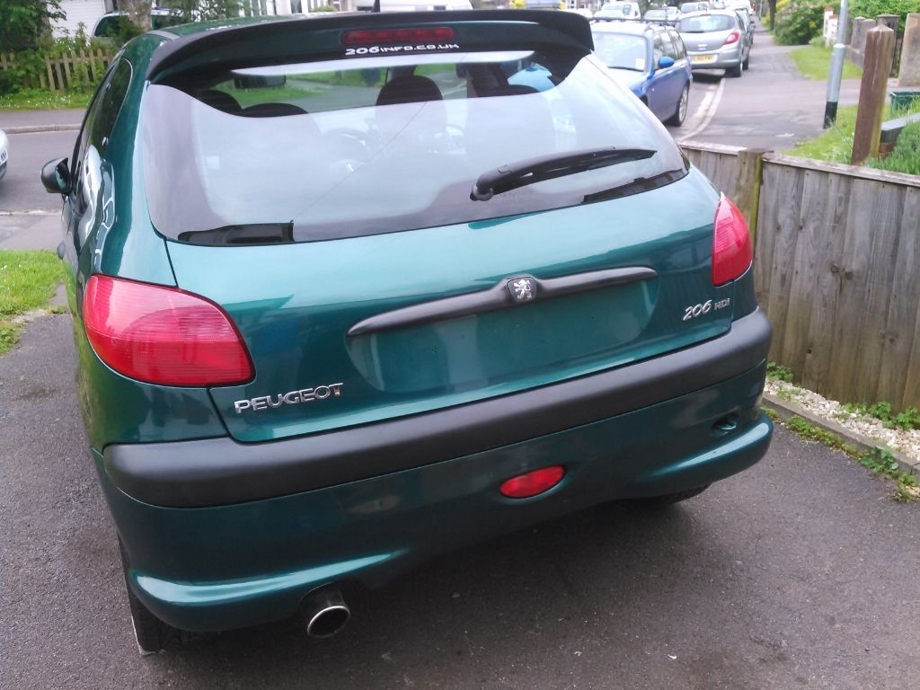

But will respray the rear spoiler either colour code or satin black just like I did to the front bumper, because PlastiDip attracts all sorts of fluff and doesn't come off without a tape

July 2015
Paid a detailer for pugfest:
Since shocks were out, was time to rust away under the arches (they'd take 6-8 hours for a scrupulous do and this given amount of rust)
Appalling view:
Sanded:
Rust converted:
Cavity waxed:
Undersealed:
Same for another side:
Rust likes this bit under headlight surround, treat it well:
Too much cavity wax caused runs (not mine):
Used leaf blower to ripple the runs instead:
Dinitrol underseal spray smoothened it all nicely thereafter, also now with Pez's coilies fitted:
Just before the moment of truth Smile
Happy with the result
Since the front was taken apart, took a chance in attempting to sort out PAS pipes (who cares if it rains, when garden umbrella fits the towbar like a fiddle Very Happy )
Ran out of time to replace the bent headlight surrounds, so put the old headlights back, meaning I had to again cable-tie the driver's side one, but looks like I'm getting better at this, should ask for a bumper sticker from Shadowstalke "Certified cable-tie specialist" Very Happy Also very happy with aligning the bonnet and wings even more flush than before (considering car's accidental past Razz ):
Followed tips online about proper carwashing, got £1 buckets from B&Q, gritguard and natural lamb's wool mitt to avoid more swirls on a dark coloured car like this:
Here's how she looked washed waxed
Dropped at the front by some ~45mm and then straight off to Lee at FCM Wheel Alignment, best specialist in Bristol:
